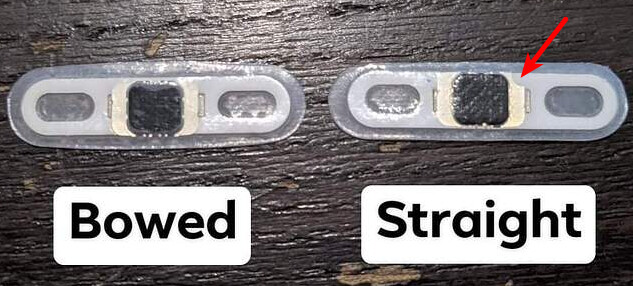

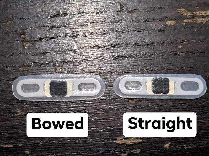

How big is the new shape and do you use it also for the Apex?
The ends are the same 7.5mm but the center now goes out to 8.25mm
Yes the Apex Flex will use the same shape
Doesn’t that require a 4 gauge needle if you want to install the flared version with a giant needle?

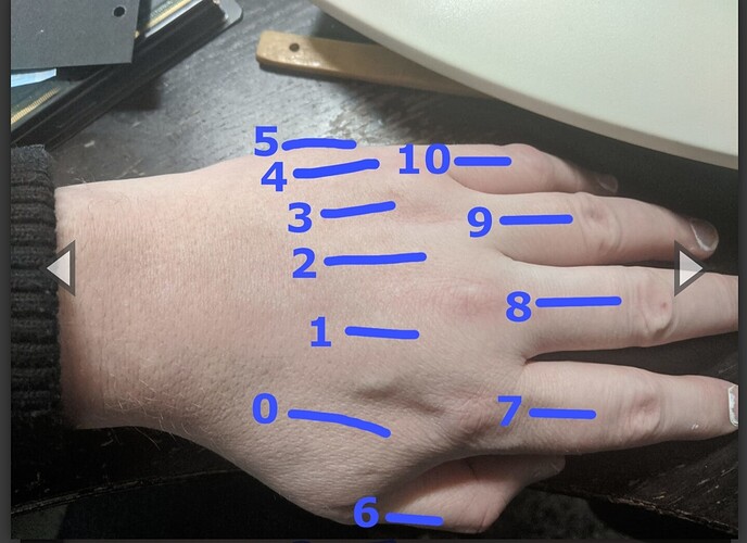

My installer said that place 4 and 5 were not so good for my hands
Because well 5 is knife edge and thats not recommended because of failure
And 4 because its to close to 5 (small hands)
So is place 3 (between the ring and pinky metacarpalbone) a good spot for the walletmor?
I try to avoid the wrist because i think at some pos terminals this would be cumbersome.
Thank you :grin:
Then its going to be nr 3 oh and yeahh your right about the terminals thats why im doing it in the right hand
The picture was of a left hand :yum:

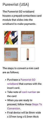

So why not a purewrist conversion?
Payment conversion
I have mine also between the right ring and pinky metacarpalbone and have no issues. My ripperdoc also advised me not to install it in the knife edge, because of broken implants at this position.
Where exactly do you mean with wrist? Its not recommended to install flex implants to close to joints.

The only thing that holds me back with purewrist is such a short expiration date. Unlike the full 8 years with walletmor @Pilgrimsmaster
Same for me. I don’t like to be cut open. The less often the better.
But I will say this: I softened my stance a bit on this because I realized something: the hard part is getting the initial pocket. Once it’s done, changing the implant for something the same size is a lot easier. It’s not pleasant or ideal by any means, and for people like me without easy access to an installer, it’s a PITA from a logistics point of view. But at least it’s only a quick scalpel and stitch affair the second time around.
I get that, but I agree with what Rosco says :arrow_heading_up:
Pretty “simple” swapout, I feel it is worth the convenience. 3-5 years might not sound like a long period of time, but once you start using it, it’s then that you realise how good it is and how many times you will even use it in even just a year.
Of course the choice is yours, but don’t let the expiry period make the decision for you.
Think of it as a functional placeholder whilst you wait for an alternative (probably Vivokey) to be available, rather than wishing you had a pay implant, you actually do…
