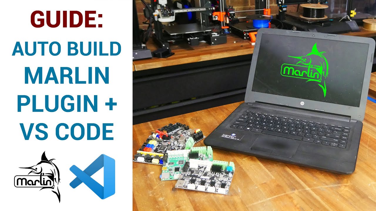

Easy. I think that the guide that Aoxhwjfoavdlhsvfpzha posted should help you out.
