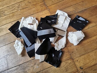

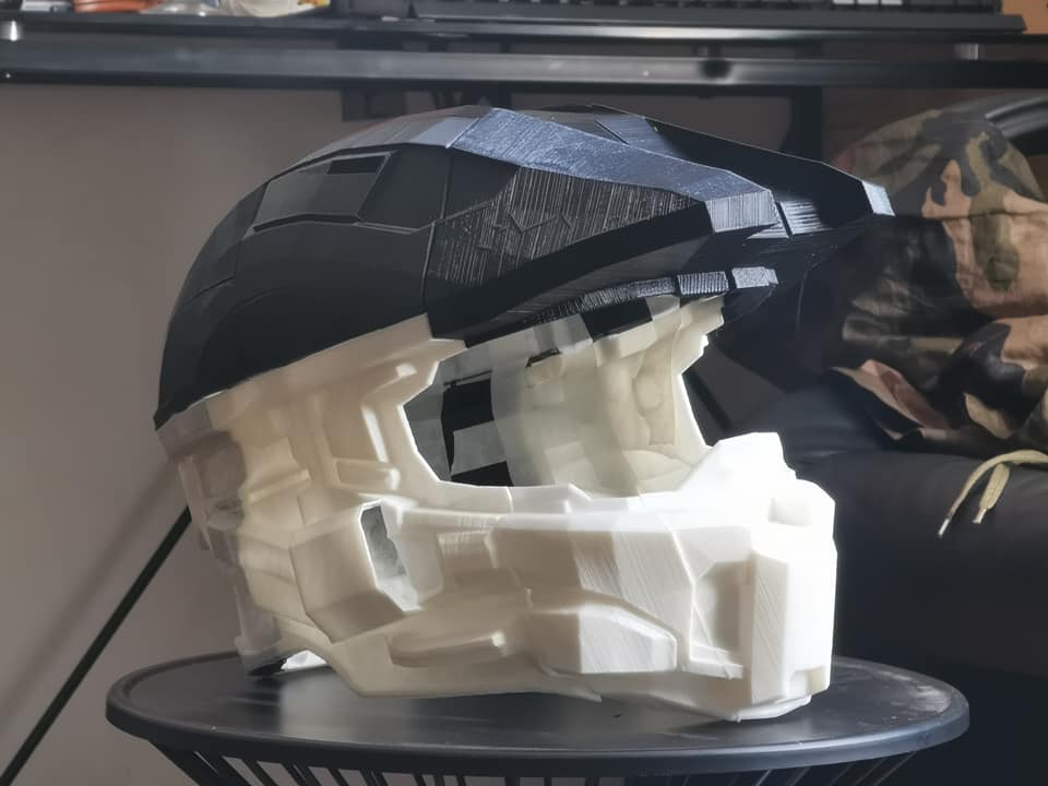

I’m taking a break right now, but the full armor is being printed.
(It’s Halo armor :slight_smile: .)
Print with Ender 3 and Artillery X1
