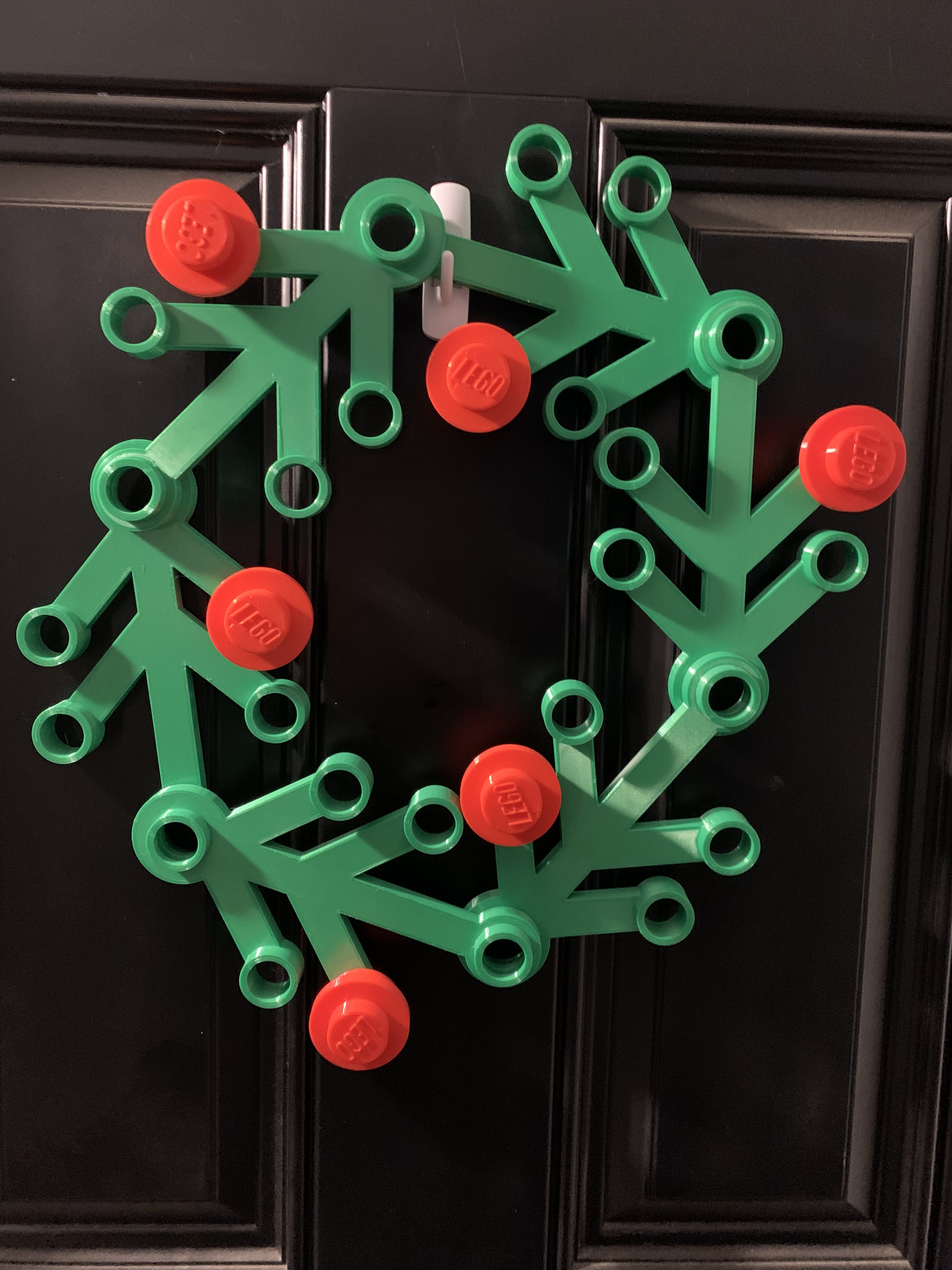

Did this for Christmas
Tweaked the model a bit to adjust hole tolerance and fit. So I can take it back apart for storage

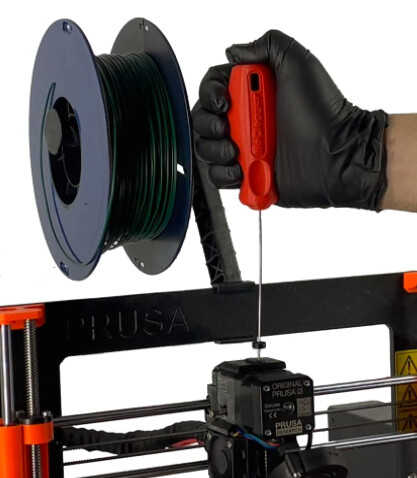

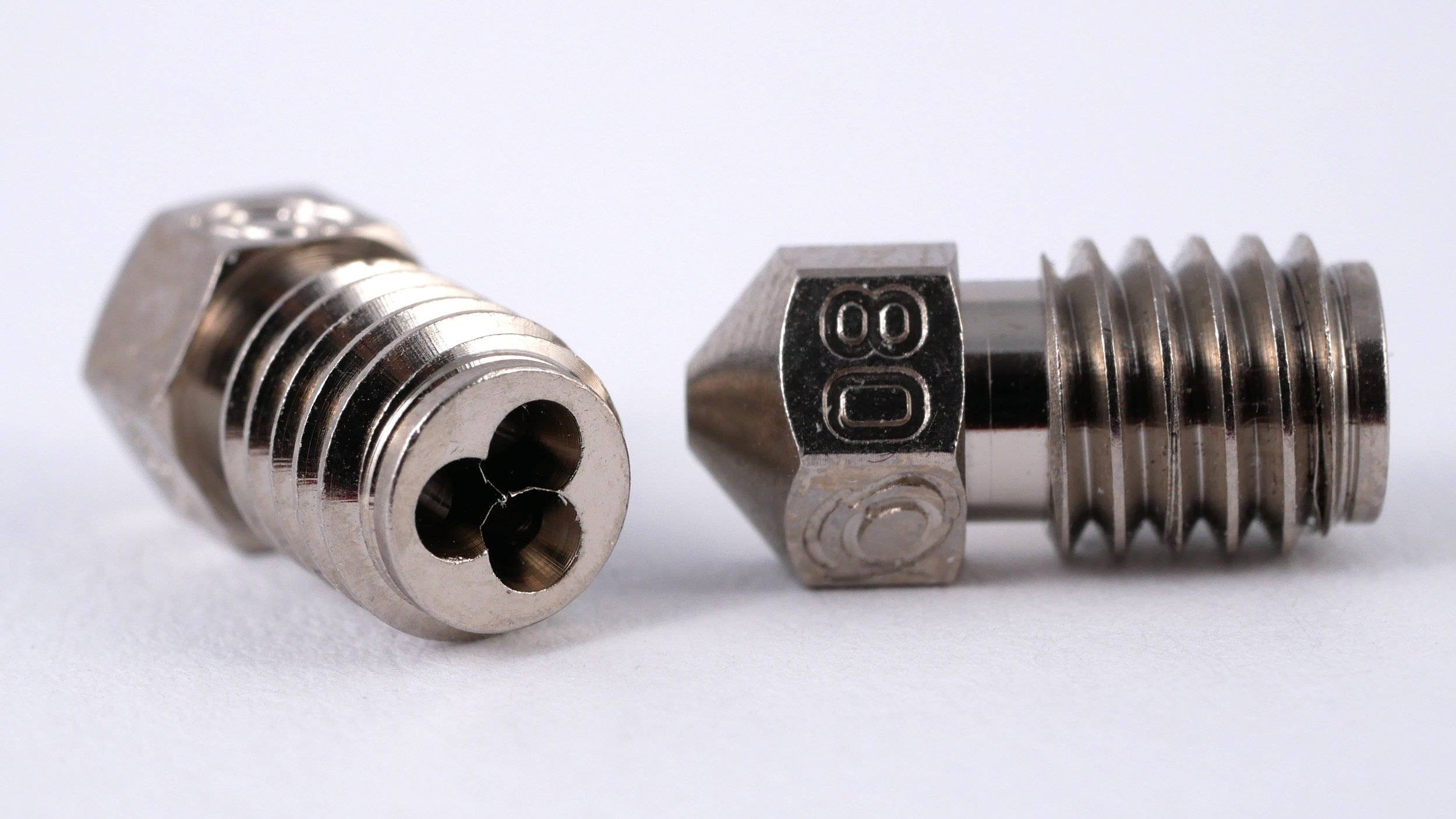

I think that I’ve got a clogged CHT nozzle, any advice on how to clean out one of these?
It’s a genuine one so a cold pull is supposed to work, however I’m not having any luck with this.
I have a spare but I’d like to clean it as these are not as cheap and easy to get as regular nozzles.
I never had a cold pull works …
find a metal rod the same diameter of the wire, heat the nozzle as high as you can and push the metal rod from the top to force all the crap out the nozzle.
I think they make them with handles on them now.
edit:
like this:
I’ve been able to get successful cold pulls out of standard nozzles but never out of a CHT.
Anyways, I just dug out two pneumatic fitting teeth out of the heatbreak. Needless to say that I replaced the fitting on the top of the hotend… Hope this fixes it.
Not sure how that’s supposed to work when you have one of these in your printer:
the whole point of it is to create pressure ahead of the nozzle, the rod doesnt go all the way into the nozzle.
its not perfect, but it what I’ve had the more success with.

Well, the problem was caused by a piece of metal that made it’s way into the heatbreak. So it wasn’t the nozzle at the end of the day.
