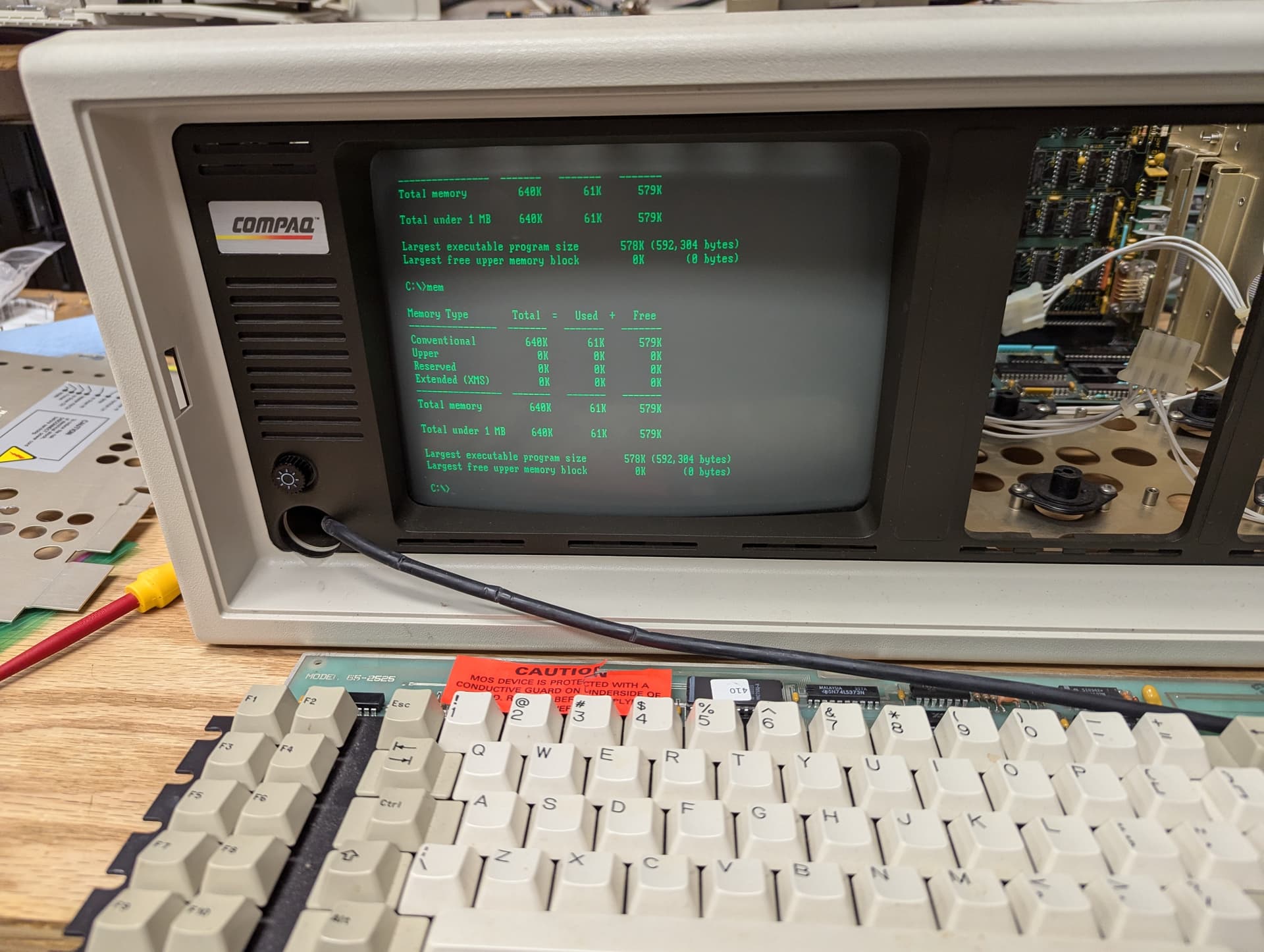

So I finally got around to my Compaq Portable. It had a power supply failure when I powered it up last year and had been sitting ever since. One of the tantalums failed short and blew up as they are known to do.
Before
After
And partially put back together. All the electrolytics have been replaced on all the boards including the analog board for the CRT. Its looking sharp and bright now.

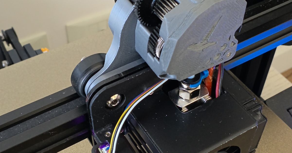

been having soem terrible prints lately and was chasing gremlins to figure out why with absolutely no progress…
Yesterday the Extruder stepper motor gave up the ghost. It was the craziest of issues too. it would work fine and then just stop, no reason, then it would start up again. many failed prints at like 30% through and spagetti factory after. New motor is now in and im back to business!
Think it was the motor stopping, the teeth in the friction wheel dulling, or the motor shaft spinning in the wheel?
I have had a few ender steppers die,
From what I could tell without testing it apart the bearing inside the stepper eventually went bad, and there would be spots that humps that would bind, at first it would only happen once in a while and eventually it would seize pretty regularly until there was almost a flat spot in the rotation
Which printer do you have?
Do note that the plastic extruder on the Enders is terrible and tends to break under it’s own tension. And that Creality makes their own motors that have a higher inductance but require less current than standard steppers, so you have to mess with the vref of the driver if you get a motor from any other brand.
Creality motors loose a lot of torque as soon as you try to print fast, but that’s only a problem if you start modifying things.
I can recommend this mod for the Ender 3:
Motor itselt would stop spinning. Tested it by taking it off of the extruder and running commands to run the extruder. It would run then stop then kind of run, then stop… rinse repeat and then it would die.
After changing it out and twisting it by hand i can confirm that is what i think occured as well as thats how it feels.

Check the motor current and driver vref if you can.
old one is already circular filed. New one is working brilliantly.
