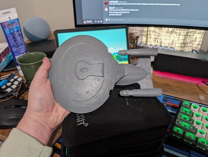

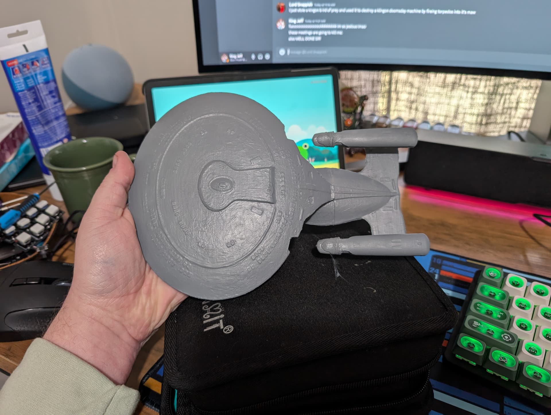

Think I found a new hobby. Started printing some Trek models to go with my new Borg Cube PC case. Still need to paint all the details on the Enterprise D.
My problem has been finding an appropriate paint. My acrylic enamel model paint is absolute garbage apparently so I’ve made a mix of standard acrylic and white gesso (gives a slightly more matte finish) and it’s working really well. Going to use my paint markers for smaller details.

I will always reccomend Rub and Buff.
its the best for small models especially to give that metallic sheen. A good prep is key though. sand down the layer lines if you dont like them. then give a nice primer spray. i like the krylon primers.
then a little bit of rub and buff goes a long way.
