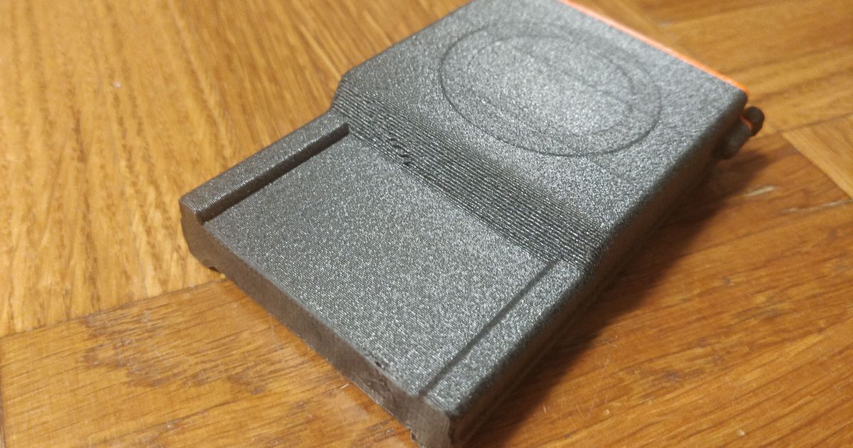

I made a thing today
I explored many different options before realizing the simplest option was the best
It’s tiny and might get even smaller
I’m also going to 3D print a tiny little case for it

I see that it uses a USB C connector but I’m still curious about what it is. Is it a light of some sort?
Nope not a light, although with reverse charging you could make a pretty decent flash light out of a phone ![]()
Good guess though, try again ![]()
LF antenner fer ya phone.
Nah ![]()
Yes, an inductor using usb-c audio output.
It’s definitely usable like that but I would like to amplify things a bit. The issue is I can’t figure out a way to get both the usb’s 5v reverse charging to power the amp AND audio output. Otherwise I would have to add onboard power which sucks
I haven’t tried a custom coil yet, maybe that could help
i think you just have to tell the phone that you are a peripheral and the phone port needs to be in host mode… then it should supply power. this is different from “reverse charging” or “power sharing” which is high current output.
It’s a bit more complicated because I’m using a DAC (ALC5686) and as far as I can tell it registers as a host. I also tried pulling power on the USB in parallel despite that but everything freaks out eventually.
I wonder if I can use a tiny Arduino to do all that manually ![]()
yeah you might have to put another usb chip in front to do comms with the phone as a periph and com with the backend DAC over another data channel
Yeah… I think making a better coil will be a better option
 USB C is a mess and I doubt I can set up something like that anytime soon. The performance is not too bad for the intended purpose anyway.
The question is, can you fry a DAC by blasting it with its own output signal? We’ll find out ![]()
Edit: I don’t know if you can hear the excitement in my voice bt YES a custom made coil is about 0.5 gazillion times better. I don’t think I need an amp anymore. I’m going to try and optimize the shape now.

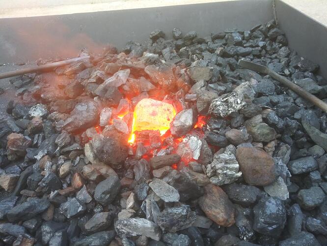

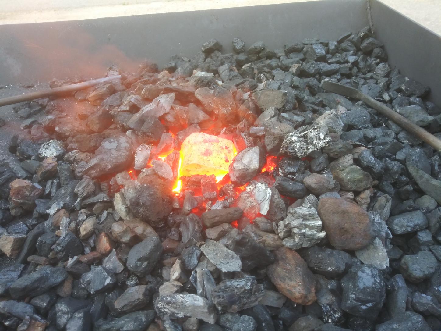

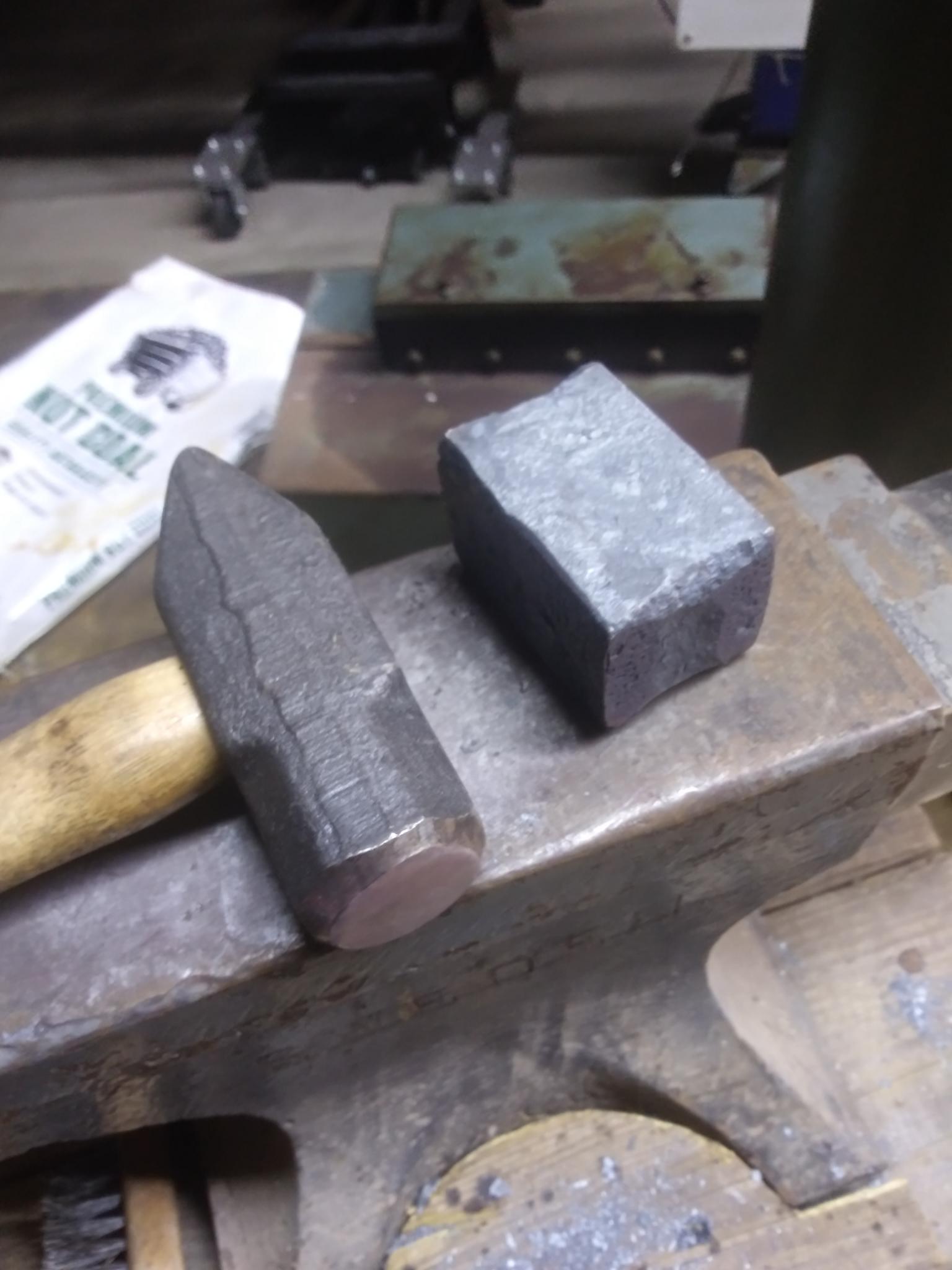

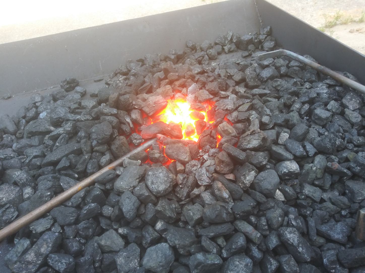

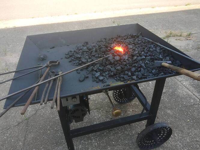

Just got the forge finished (finally).
I started off with a round piece of 2" bar stock, cut to length. Will eventually become a 2lb hammer.
Makes me think of the “How to train your Dragon” quote.
“Molten Steel, Razor Sharp Blades, Lot’s of Time to Himself, What could possibly go wrong?”
Also, bored me is dangerous me. Just FYI.

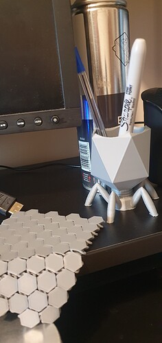

I got myself an ender 3 v2.
I wasn’t expecting much for 200 quid but i cant tell you how impressed i am with it.
The quality is fantastic on standard settings.
So much open source stuff to download. And blender is quite straightforward with a couple of youtube tutorials I soon had the basics.
I guess it depends what you want it for but this is plenty good enough for what i need.
Pic of my recent prints downloaded from thingiverse/printables. Bacteriophage pen holder and nasa chainmail material because why not?
