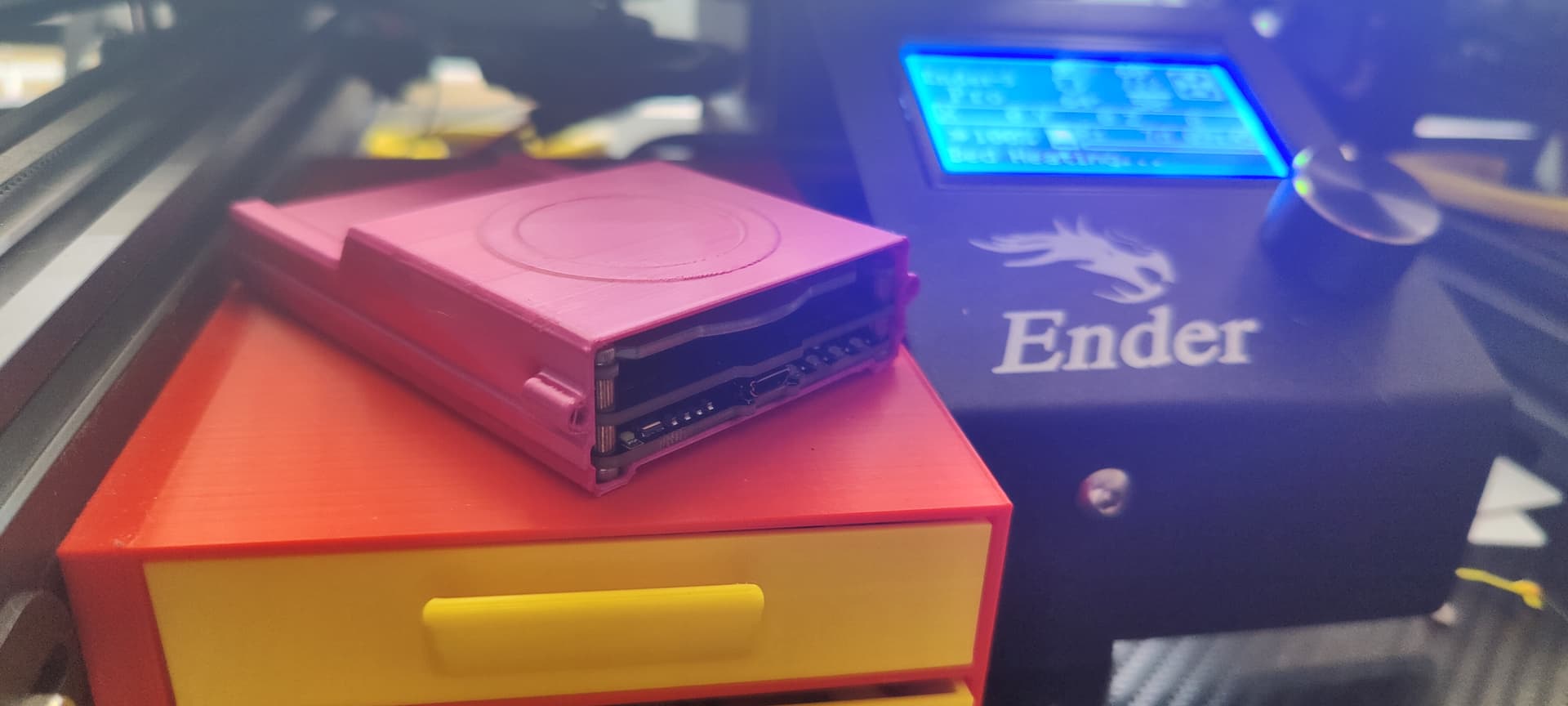

Print it standing on the “nose” with a 0.4mm nozzle.
Does that mean like this, or flipped 180 so it’s standing on the skinnier section?
I also would have thought NOSE was the 180⁰ of that, however, printing it your way, gives it the same print path as shown in the example, plus it will not require supports for the underhang, therefore: cleaner build, less work, less material, less time, less post processing.

I’m trying it with the position in my screenshot. If it doesn’t work out, I’ll flip it around.
The stl had it laying flat on it’s bottom side when I opened it in Cura so I have to flip it one way or the other.

It fits though! A little too well I can’t get it back out XD
You can always scale it up 1-2%

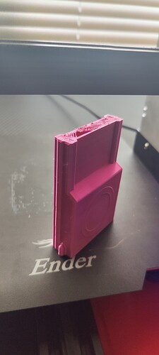

Yeah, I’ve got it printing again on it’s nose.
Let me know how the nose print goes. Hopefully it can still read glassies in it.

Printing on a small scale is hard! Every little defect stands out :sob:

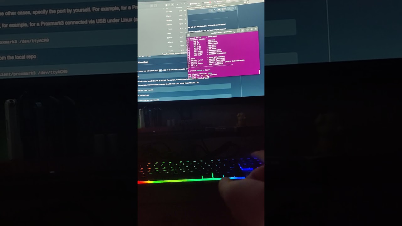

Successfully read my NExT with the case on!
nvm, think I figured it out.
Gotta slow down
Make sure your not over extruding
Make sure you have proper minimum layer times
Drop the heat a bit if possible
Also try printing only 1 part at a time, so no travel hop zits… a million settings for travel and retractions… you can ignore all this by printing one at a time
