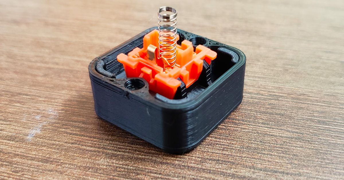

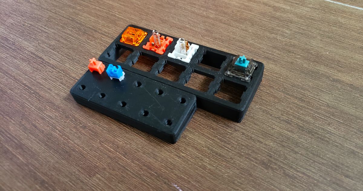

I’m printing these for lube purposes:
Any advice before I take my keyboards apart?

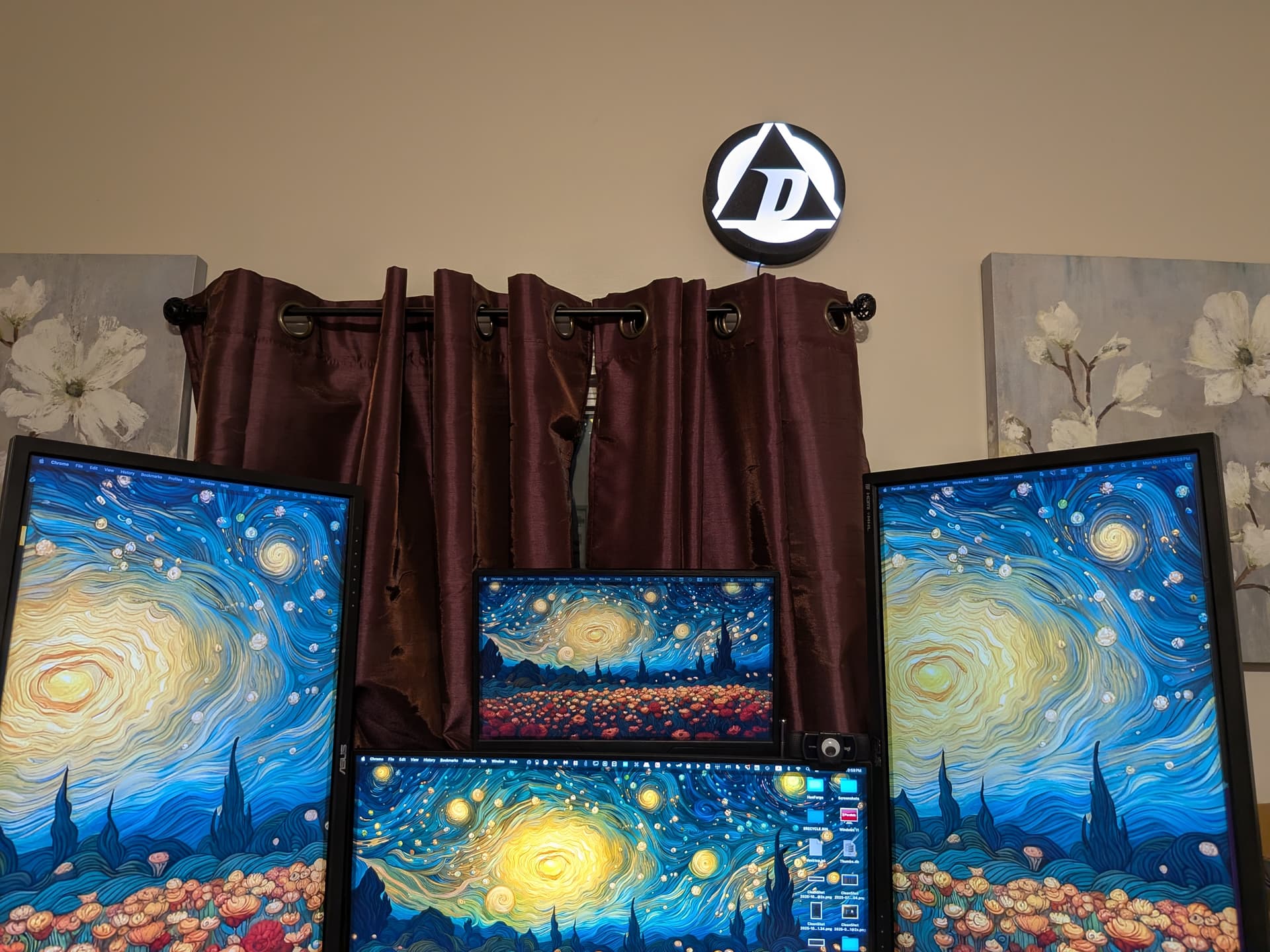

Made a DT Lightbox for my office! I also posted it on Makerworld if anyone wants to print it!
@tac0s @amal Please let me know if I have your blessing or if you want me to take down the model for copyright reasons
Copy away friend :slight_smile: I think it looks awesome!
You gotta stretch that background across them screens
