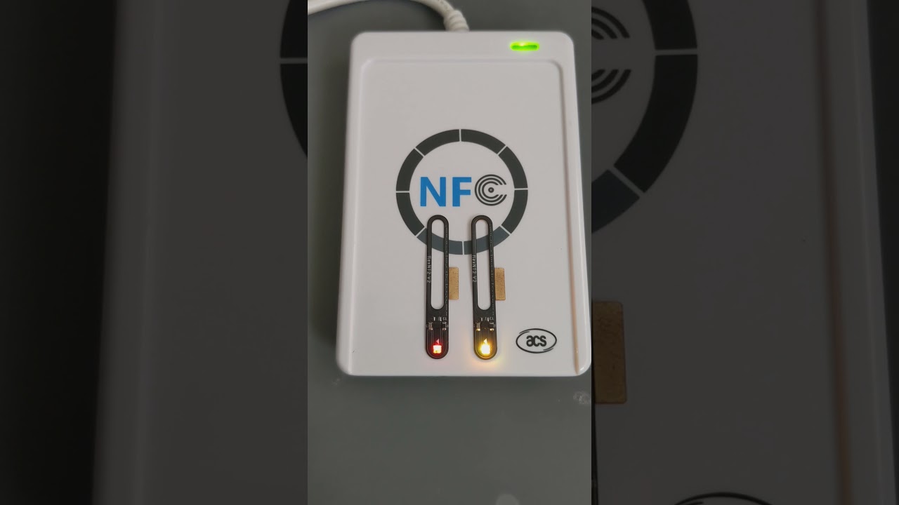

Hopefully this bad boy gets released this decade :unicorn_joy:
I’m still literally waiting for the company that makes the magic silicone resin used to protect the passives on this board to finish their reformulation so I can test it and purchase production quantities. It’s just the right durometer, it’s one part not two, and cures with specific UV light which is why I built the UV curing thingy… but they have been at this for nearly a year now.
