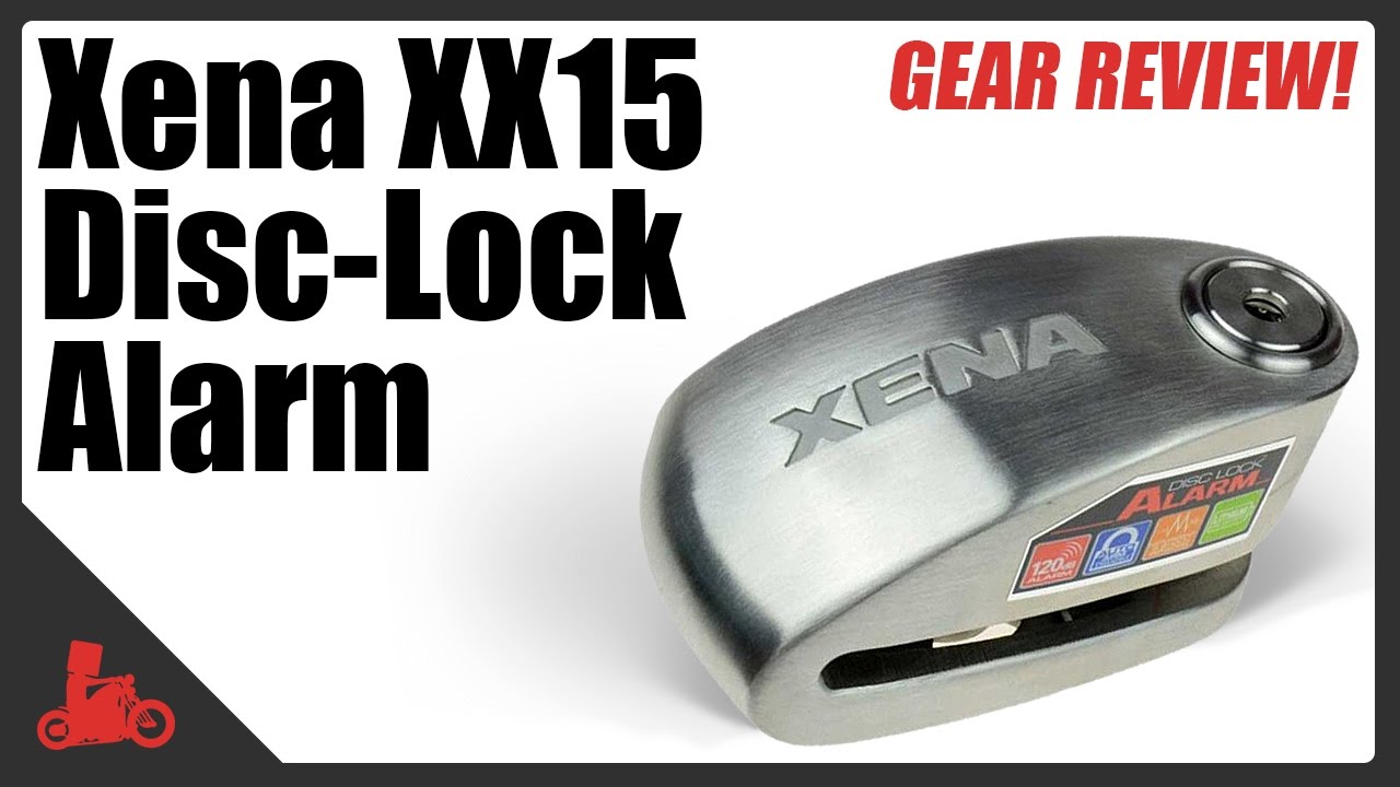

You guys should look for something like this. Seems to be a good option.
I have a disk lock, but kind of a pain to use all the time. After seeing the videos, trying to keep the steering lock seems pretty pointless. Just park it when I go to the store and chain it to something solid If i’m going to leave it for a while. I hate lowlife thieving scum.
Yeah the problem with those disc locks is that it’s yet another key… that’s why we have implants!! But I think this alarm video shows that a solenoid pin in the disc approach could easily work.
Indeed that is the reason for an implant, very tough to find a middle ground between peace of mind and simplicity. Maybe one day we will get the best of both.
It might be possible to take one of those disc locks apart and mod it with a solenoid and reader… but that’s a serious project and expensive since the alarm probably isn’t cheap.
