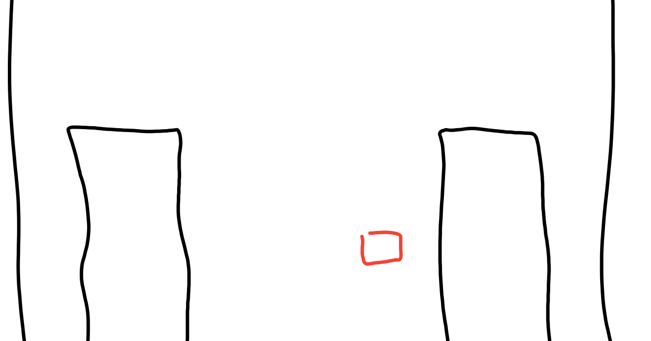

The main door id be using this on would be my dorms entrance, and it looks like the included image, where the left rectangle is a key door and the right is the scan door. The red box is the scanner. Sorry about the poor drawing skills as well, I drew it up on my phone.

As far as where to put them for badging, It’s really personal preference. I’d go with webbing for that, but you need to consider how much you’ll be using that implant after you graduate, yea? What I did was spend a week just looking like an idiot swiping my hand against the readers when I walked in to see what felt natural before I got them in.
There’s no harm taking your time, beats regretting install location/getting it cut out to get repositioned.

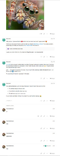

I’ve been meaning to ask if there’s a way to reset that guy. I broke mine before I could get the badge…
Lol
This is why we don’t buy you new toys @ThexTallxDude
Lol
What do you mean broke… can you take a screenshot of the last post you did with “him”
ie. where did you get up to?
It’s so fun to learn about things by finding out how much they can take though…
That’s why I do the job I do :slight_smile:
He just doesn’t reply anymore…
^ Was a lie :frowning:
