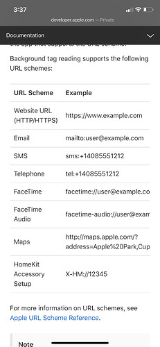

Contact details and locations have issues on my SE gen2. However, links, email, text-to-phone numbers, social network info, and shortcuts all work well when written from the NFC Tools App. I can do some more thorough testing later this week.
Contact details are vcard, which Apple has turned off native reading
The question is will your SE scan something without using an app?
It sounds like from what I’m reading, the SE requires an app to read or write tags, no background scan
I’m pretty sure anything pre iPhone Xr doesn’t support background scan
