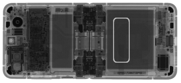

Hey @Steven1727. I also have the Z Flip and blinkies. How do you position your Z for the best viewing? I’ve been folding it to scan, though viewing is still a tad behind the phone…
Thanks, @Pilgrimsmaster. As per your diagram, this is what I always thought. Though I found this image below which is a little more detailed.
I can only get reads and blink (from my xLED, xSIID is still not visible yet though readable, 7 days old) within/around the grey rectangle. I have confirmed this with my X Field Detector.

That same gray rectangle is what I’m seeing on the Fold3 as well. That’s the part of the phone where you normally hold it so it’s really inconvenient to use and it’s impossible to see the blinky on an xSIID.
The Samsung Fold 2 reads glassies pretty well. The best location I found is on the back about halfway down. I can get consistent reads towards the edge a bit, in between the top of the power button and bottom of the volume rocker
