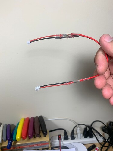

Yea I extended it for my big gun safe project
Don’t judge my quick heat shrink solder joints, they haven’t failed me yet, and are super quick

I’m not judging you and want to get myself some of those for testing purposes.

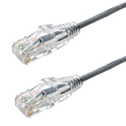

Personally I have done some long extensions and used thin Coax like this
and some thin shielded network cable and just twisted up a couple of pairs
like this

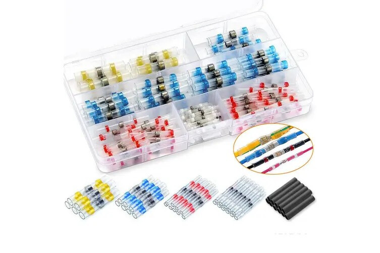

They work quite well, although I tend to use solder and heat shrink far more often, but, if I have a solder splice of the right size, and it’s nearby, and i’m only joining 2 wires of the same guage together I would use it.
Soldering gives you a number of joining method options, the splices, only require basic wire prep ( Stripping and cutting to length )
The place I have used them the most would be on vehicle wiring.
You can buy them in sets
My Opinion, there is a time an place for them and Eriequiets project is a good example.
