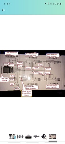

This is the wiring diagram for the door lock module and I was just wondering if I can just connect the wires from the xac directly to it or if I would need something else.
Also if possible which Xac wires would I put where?
Thanks for the help because I have very little idea as to what I’m doing.
so in order to close and open the door you have to connect to white or brown wire coming from the front door actuator momentarily to ground. so (white = close, brown = open. or vice versa :wink: )
i have no experience with the Xac, since i use an arduino to control everything.
edit: the xEM AC v2 has only 1 relay, so it is not feasible that you can open and close the door lock with what you have. at discord i saw somebody developing a “simple sexy” board. with a microcontroller, a reader and couple of relays. So i guess that will be the “easiest” to get you started.
I think its called a simpleAC now but yeah it works really well for this providing you are happy to change some simple code. In fact it’s exactly how I’m about to mod my car for lock / unlock with my xsiid.

So to hook up the xAC to just lock the door you would put the common (of the relay) to ground and the normally open (of the relay) to the white or brown wire (which ever one locks the door).
