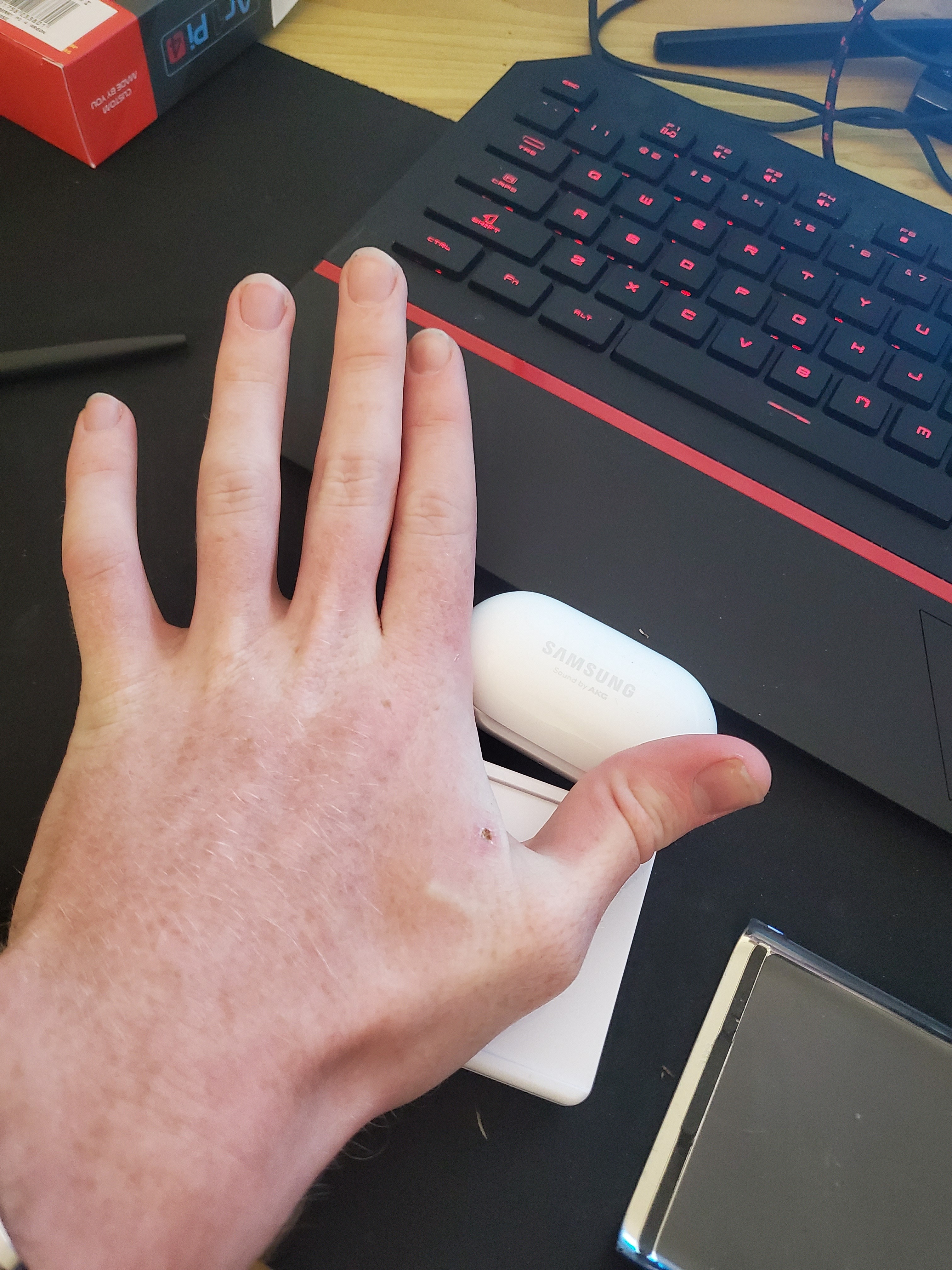

Here are some photos of the site and myself trying to scan it with a reader, confirmed reader works with an nfc ring, tried samsung galaxy z flip and samsung s10 ontop of this as well.

It is possible the chip has decoupled from the antenna inside. Can you move your hand down the acr122u so your chip is positioned and oriented like this;
In the position your hand is, shown in the picture, would not likely get a reliable read on the acr122u.

that was an example, ive manguled my hand in various various different ways, just tried it your way as well, ive moved the reader around my hand left right upside down every angle i can think of, still nothing

That makes me sad. I think it’s possible the chip has become decoupled from the antenna. If you can’t get a read with the acr122u then it’s likely the case. I’m very sorry about that… we can send you a replacement, just use the orange help button on the website and submit a ticket with your order number… or just reply to your order confirmation email with details and we’ll get it sorted.
