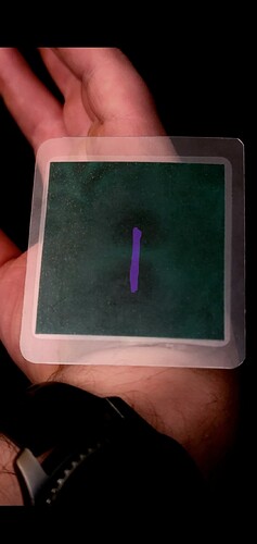

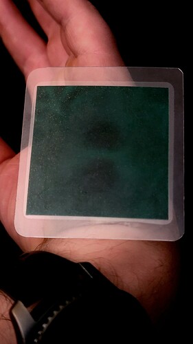

I ordered and just had the xG3 diametric magnet implanted in the knife edge of my hand. I was using the magnetic viewing film to check the placement, and it looks like I received the axial version instead of the diametric. I’m worried because there is a distinct line horizontally instead of vertically in the field.
can you draw a line over the top of that photo where your implant is orientated!?

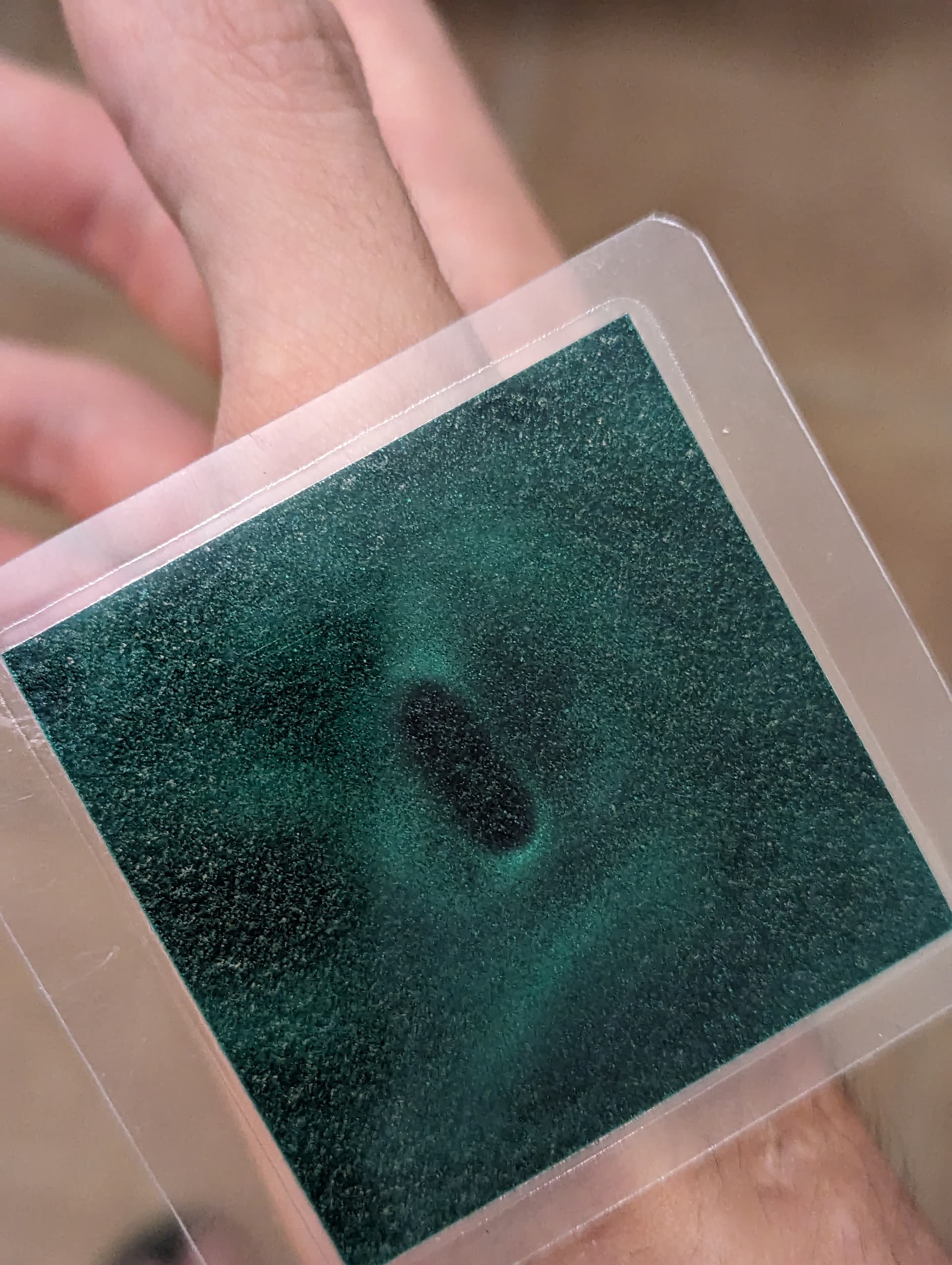

Here is axial

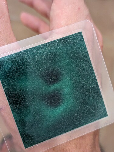

And diametric for reference
In a 90 degree rotation diametric can also look like this:
Your does looks axial
Yup, you have indeed recived the Axial one.
