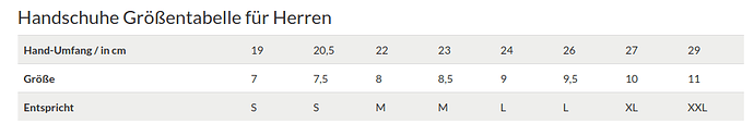

Most glove scales only go to size 11.

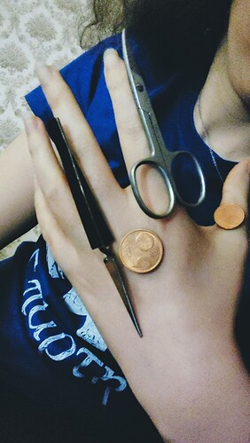

I have not so big hands and especially the fingers are veeeery skinny. Maybe I add something here to give you a better comparison… Let me sort something and I get back to this point later on. :grinning:

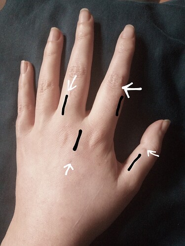

And here a picture to explain.
I marked the magnets black here, incision are marked with white arrows. (I tried to make the black markers approximately as big as the xG3 is, so you might be able to imagine how big my hands / fingers are.
