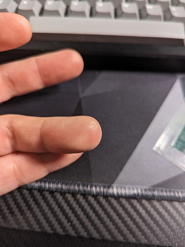

One week update.
Entrance wound is all but healed.
Skin is starting to shed around the healed area.
I’ve been very diligent in keeping the xg3 in the center on my finger a good distance away from the entrance.
I can feel fluid within the cavity that was created around the xg3 in the space that it does not occupy. It doesn’t hurt but it’s definitely bulging the skin in those areas so very minor swelling.
Where the entrance wound is it is almost completely numb. This is expected as that area severed some of the arborized nerve branches. This will heal and they will regrow.
Overall I’m very happy with the install. It was definitely spicy and I highly recommend doing your due diligence of you decide on the same location please read up.
