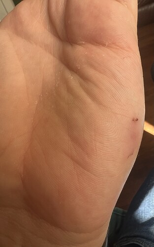

Had an xG3 v2 installed about 5 weeks ago and it seems to be regularly irritated.
It was done by a professional installer into the knife edge of my left hand.
There’s no heat and minor discomfort if I bash it into something by having no spatial awareness. The redness comes and goes through the day.
The dark little lump worries me a bit, so I’m just seeking some reassurance. There’s absolutely 0 sign of infection.
Thanks.

I managed to get a better photo of the black spot in it
Did you watch the installation, or do you have any pictures or video of it? Do you know how deep the needle was inserted, or the angle of the needle (parallel to the skin vs slightly angled inward)? Is there a chance the magnet has started working its way back out? Sorry for so many questions, but more information on the install may be helpful.
This is just speculation on my end FWIW, but as you can see pictured below, the end of the magnets are definitely dark to black colored. I don’t want to alarm you or anything, but I’m unaware of anything else that would cause the black spot.

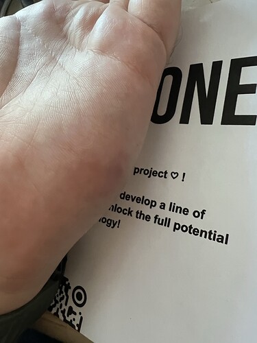

I think the end of the mass is surrounding the end of the xG3. I’ve managed to get a better image showing how the xG3 is sitting. I think one end is sitting slightly higher, which is where the insertion site and the dark spot is.
Thanks for that, it’s the entry point that has it. That would make a lot of sense.

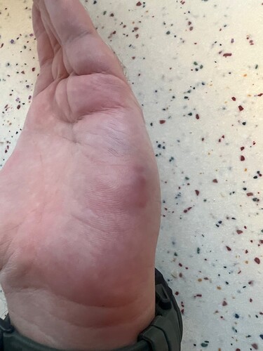

Many thanks Amal, I thought I’d post an update based on your suggestions.
I got a medically trained friend who isn’t squeamish to take a look, and push it further down into the pocket.
I did not enjoy it (painful), but he felt a good pop as it moved further in.
I then took the popsicle stick advice, which seems to have really helped too.

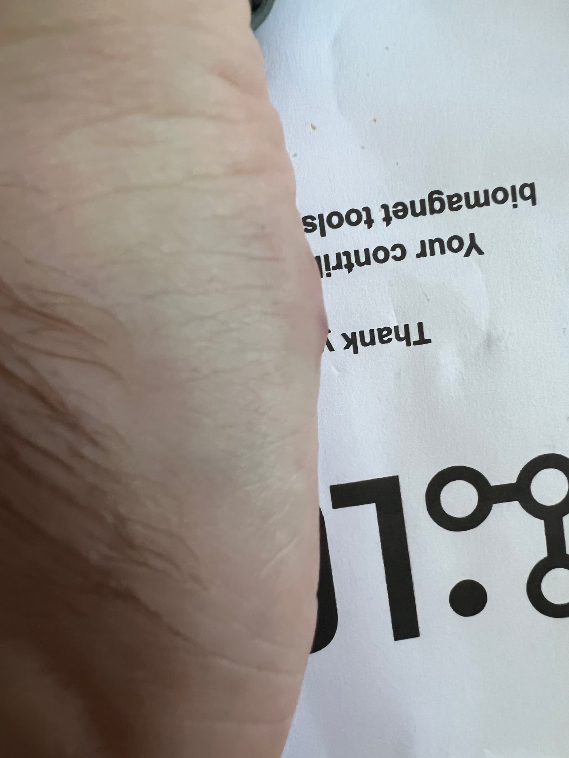

I’ve got photos here for comparison, and to me, it looks like the magnet is sitting much flatter and the discolouration has dropped notably, even just overnight.
Is it worth repeating the pushing it down to get it settled, or should I let it recover some more first?
Ah nice. I would keep the stick and cotton going for a few days at least (off / on not just on the whole time) if possible.
It’s getting there, it’s definitely sitting much flatter, and it’s less aggressive in trying to poke back out too.

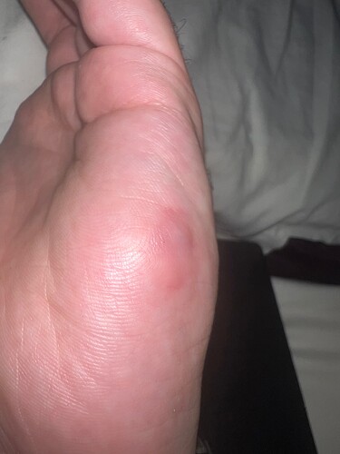

So, about 6 weeks on, with lots of stress and general malaise (including COVID), I think the implant really doesn’t want to move from where it is.
It seems to move in and out of the pocket, and at the ‘worst’ moments, it’ll look like the photo above.
But other times, it’ll sit perfectly flat and you won’t see that it’s there.
I’ve spent lots of time with popsicle sticks, and the ace healing helpers from this thread https://forum.dangerousthings.com/t/x-series-injectable-healing-helper/19856, but I still end up back here.
I’ve also been on prenatals for most of that time too, to really try and help things settle.
There’s no pain or discomfort it’s giving me either, so maybe I am just being overly concerned.
Annoyingly, typing seems to aggravate it, which, working in IT, isn’t super helpful.
The three photos are taken within a couple of minutes of eachother, to show how quickly it goes from looking quite sad and poking out, to retreating again.
