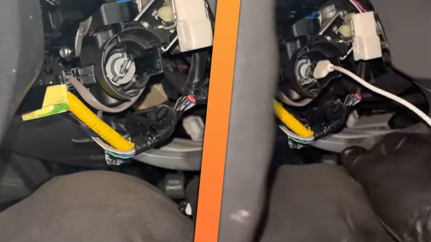

Well, if it’s a Kia you wouldn’t even need the dog.
Why, are KIAs really easy to open/start? I have a KIA and I’m hoping you say yes.
Apparently, once you pop off they key cover on the side, you can use a USB-A connector (that fits perfectly over the key start) to fire it up.
(random image off the net when searching for “hotwire kia with usb-a”
