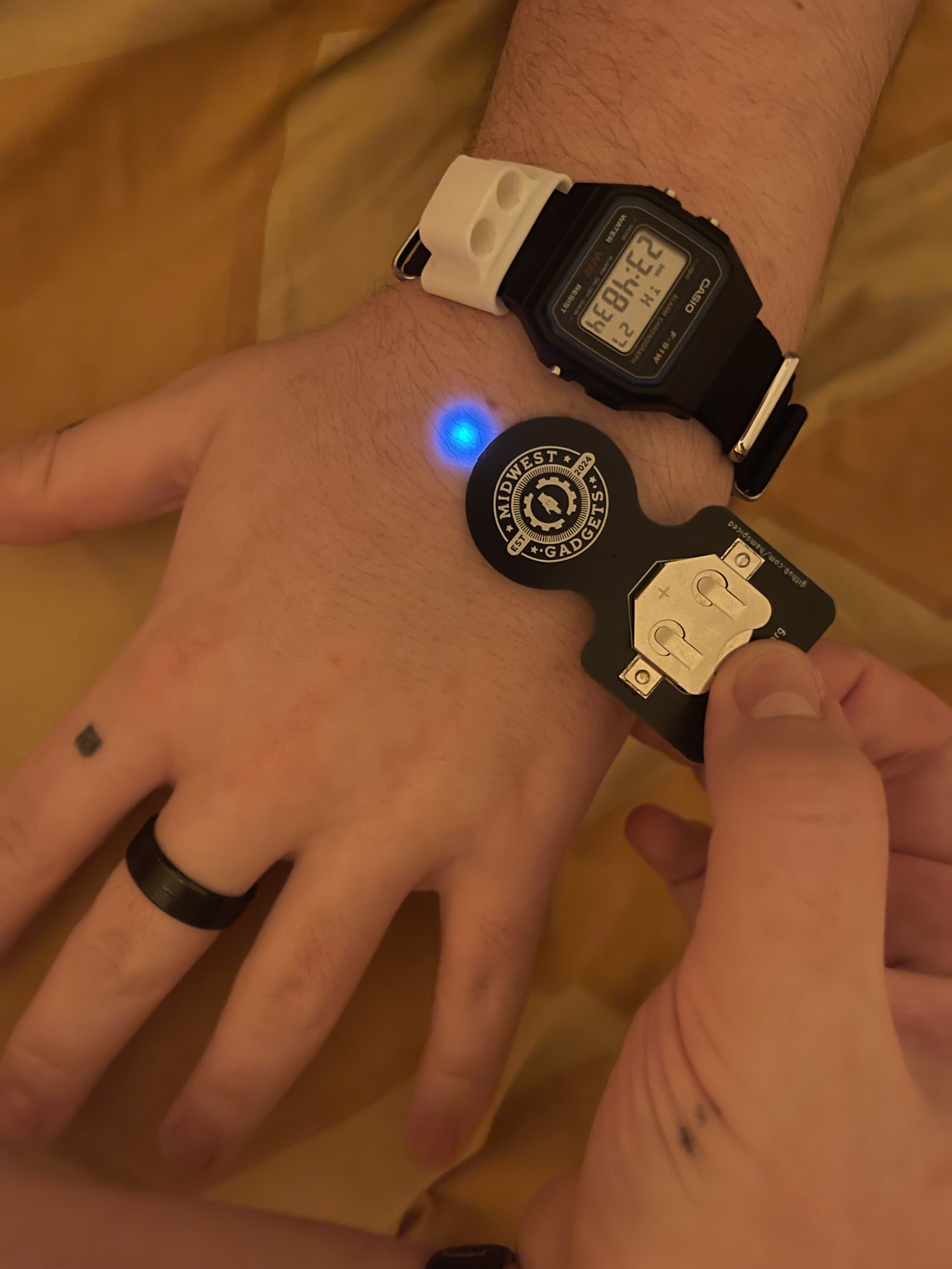

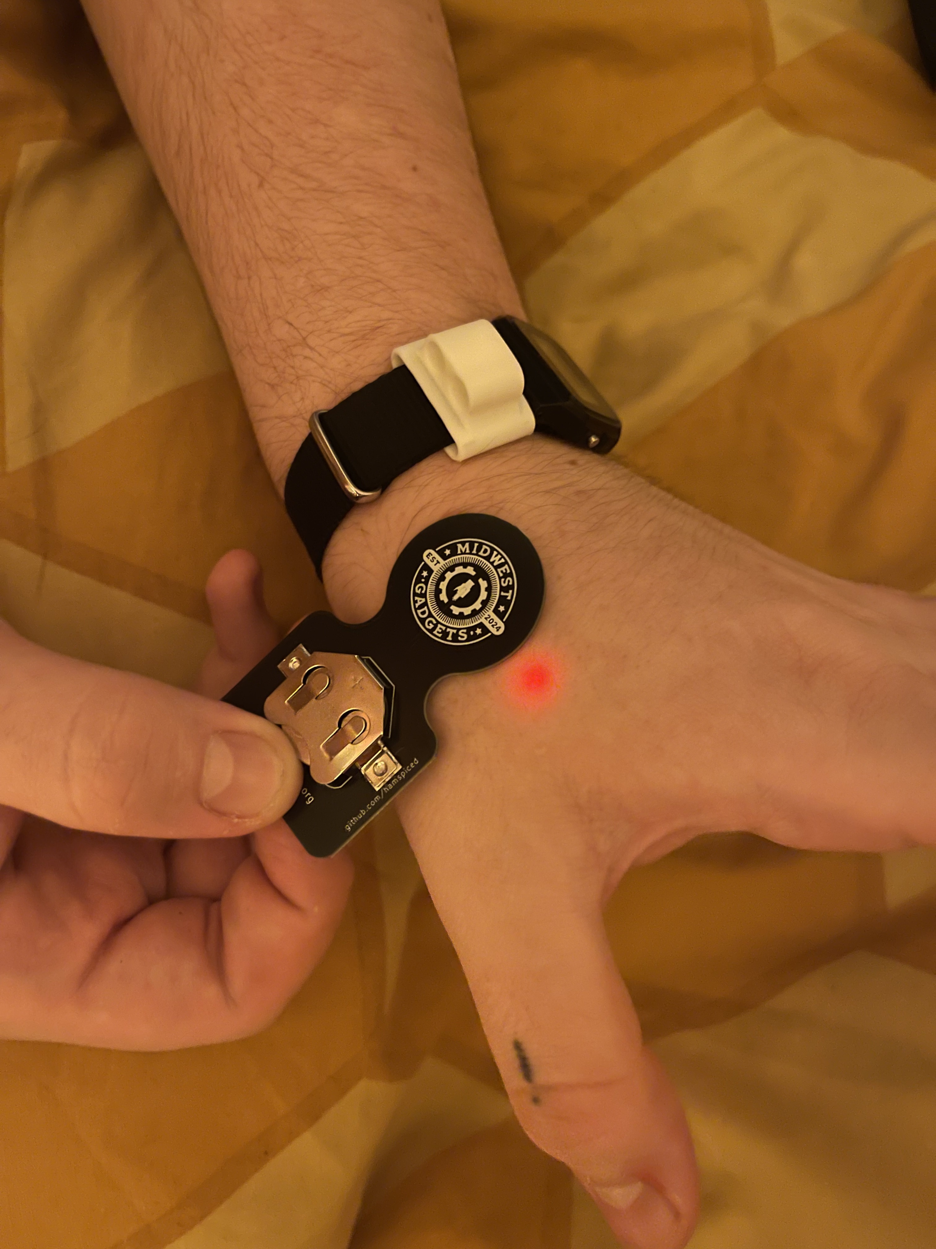

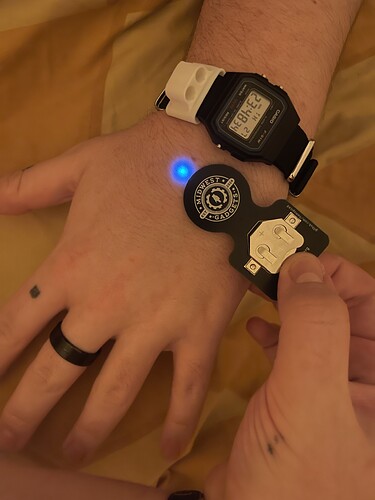

https://www.midwestgadgets.org/product-page/13-56mhz-field-generator
this is a must have.
using my phone is alright but this doodad is the mvp for showing off my lights at functions.

I received your order and it will go out today.
I wanted to add, i think this is a great project, and the field generator will be excellent to show off your new blinkies. As have been mentioned before. Installing the blinkies you will likely not be able to See the light or be able to trigger it for at least 3-4 weeks after installing. And even after that time it may be dull. In time though it will get brighter and brighter so dont think you have a dud! its very very common.

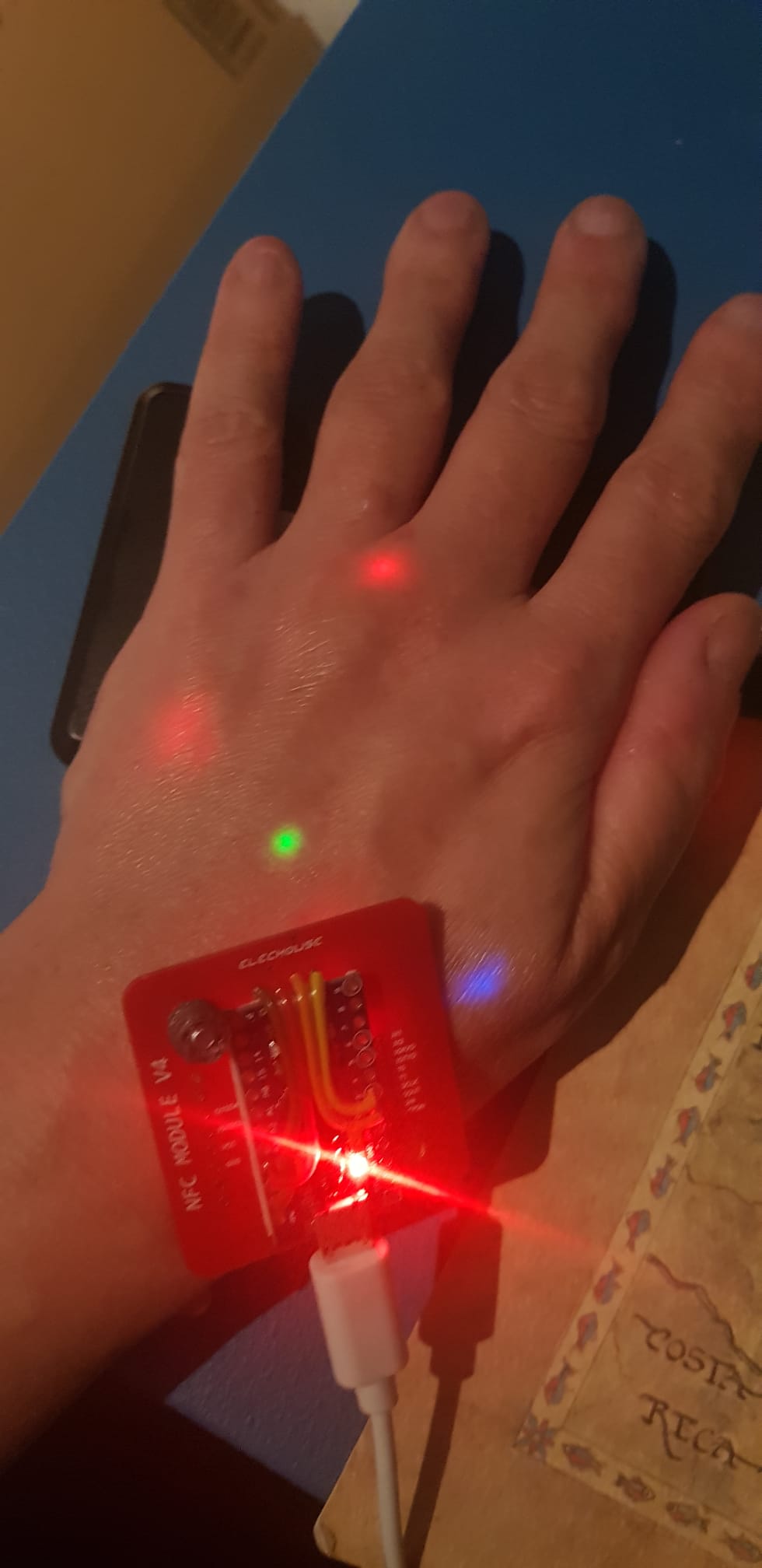

i also make a DIY version of this field generator if you know your way around a soldering iron and want to try your hand at maybe a field generating bracelet like what has been mentioned here before. its a very simple design and shouldnt be difficult if you have the drive to do it.
Here:
