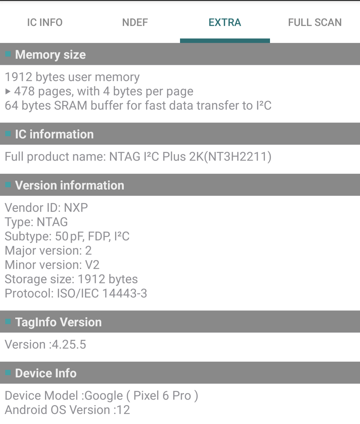

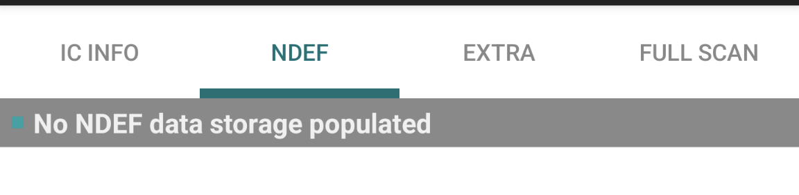

Can you post a screenshot of what nxp taginfo reads?
But I believe the process of amiibo cloning sets the lock bits. It may not be recoverable.
Here you go. On the chance that I have entirely bricked it, does the warranty still cover it?

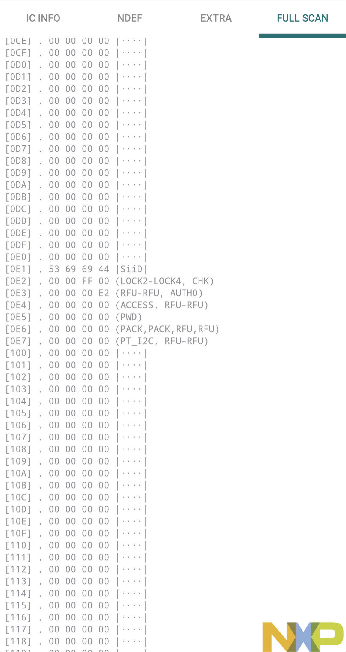

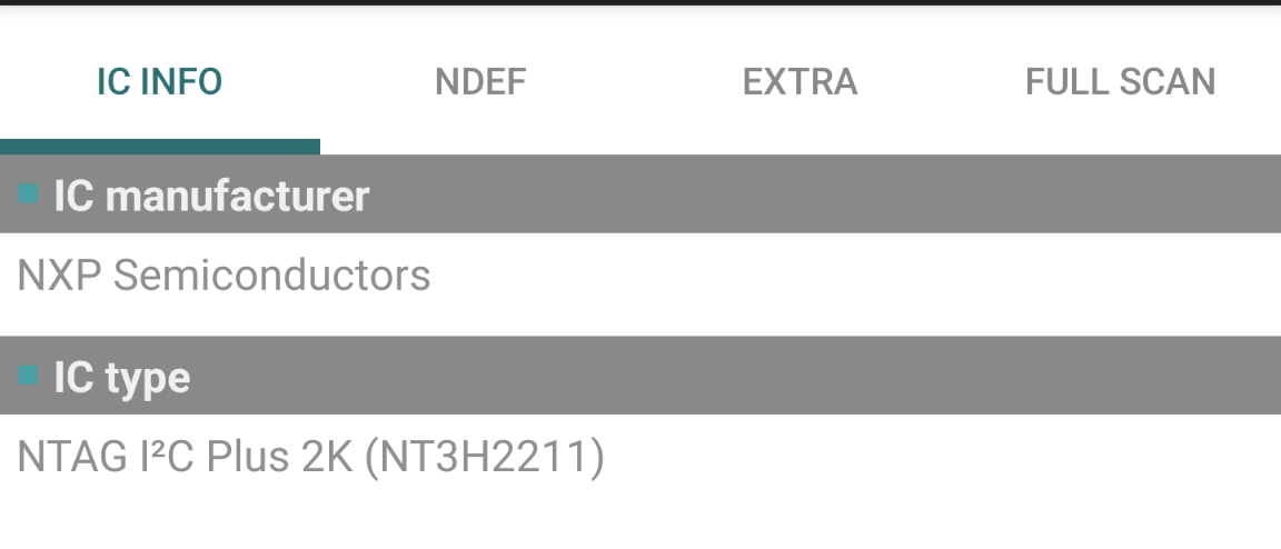

I need to see the “full scan”. In particular the configuration bytes in the top, middle and bottom.
You’d have to ask @amal about warranty but since it would be user error, I’m not sure.

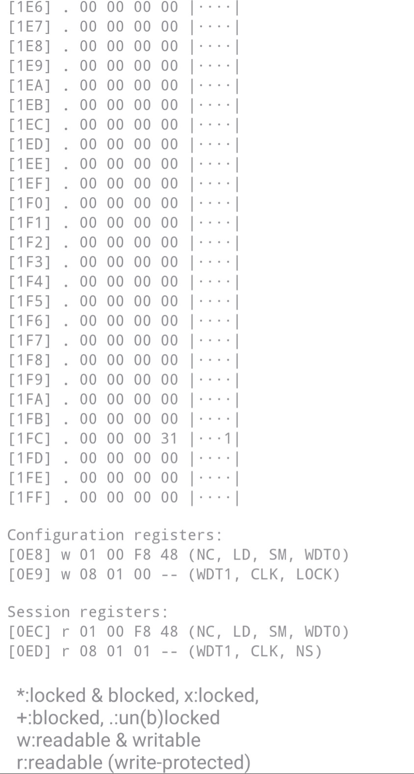

It didn’t show up the first time but here you are. Seeing this now I’m not hopeful. Thanks for the help though! :frowning:
That all looks the same as mine. You may just need to format the chip.

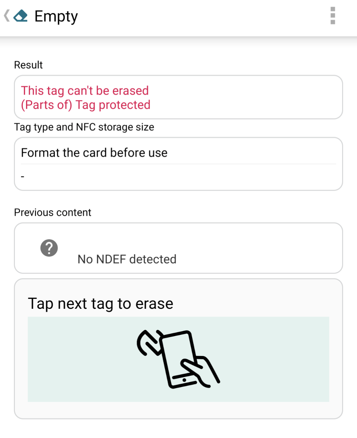

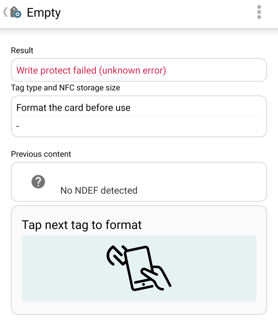

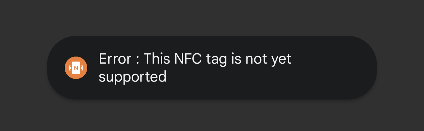

Welp, unfortunately whatever I did to it seems to be silver-bulletproof.
Both NFC Tools and TagWriter have failed to reformat to NDEF after a few times of trying. Trying to just fully erase with TagWriter claims parts of the tag are protected, on NFC Tools it claims the tag type is not supported, and trying to format with TagWriter throws an unknown error.

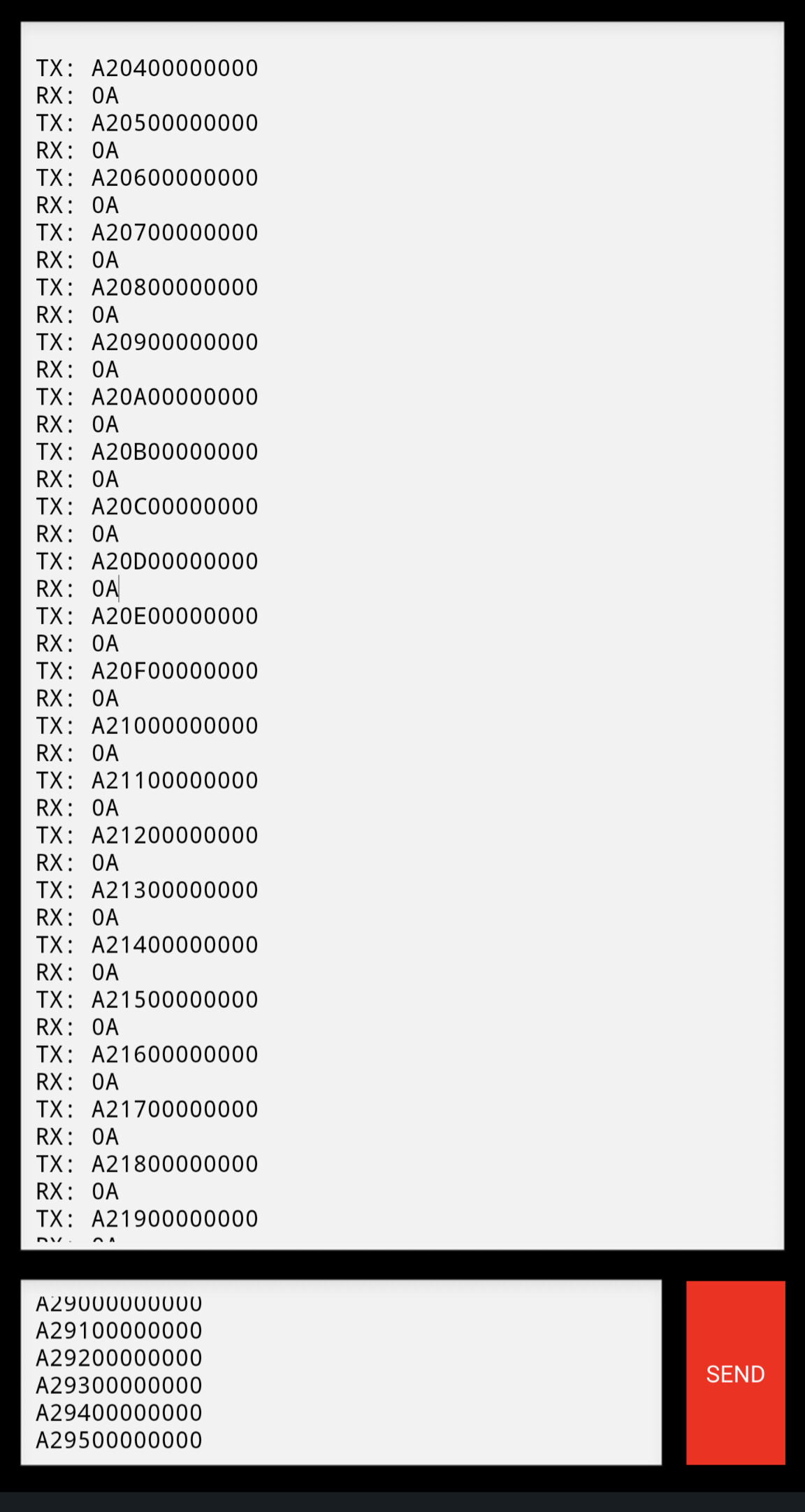

Download NFC Shell (https://play.google.com/store/apps/details?id=com.emutag.nfcshell) and paste the whole list of A2 (write) commands from this thread. This is a rescue operation type thing so don’t mess with NFC Shell in the future unless you know what’s happening. In this case it will send the command “write zeros for every byte” to every page in the user memory of sector 0. You should be able to just paste that whole block into NFC Shell, but if it’s gives you trouble you can break it up into smaller chunks.
Unfortunately I’ve returned to get more help. When I paste the command lines into NFC Shell it consistently returns “format error in command line.”

Nevermind! Turns out I was putting all the commands in the display line, not the command line!

Ok new problem. Even after writing everything to zeros, NFC Tools and TagWriter still return the same errors as last time.
And just for fun, here’s the command line and terminal response from NFC Shell (or at least what I could get in one screenshot, it’s uniform responses from the terminal all the way through).
ok great screenshots…
can you scan with taginfo and post the full scan data?
Dont want to panic anyone but amibos are locked tags is it possible thats whats happening here?
Simular to what @Satur9 had you do but do it with these commands please

I already compared the config bytes of his to a known good xSIID. They’re the same.
