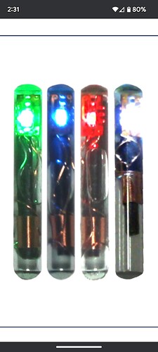

about half of the volume is filled with resin. the part where the LED is should be submerged in resin.
(i analysed many DT implants bc i diy built my own glass implants.
The analysed DT implants were made like described above)
