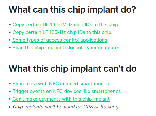

Hi, just adding to this topic because I can’t seem to find a clear answer. Is the xMagic able to share info with NFC-enabled phones or not? On the description of the xMagic it says it can’t, but in other posts on the forum, people say it can.
It’s a Mifare Classic style chip so it can’t share standard NDEF records. But some phones support something similar with those chips.
In other words, only with some phones. Specifically the ones with an NFC chipset that’s made by NXP. iPhones are not supported IIRC.

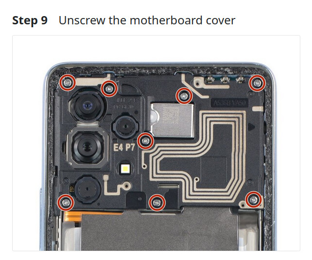

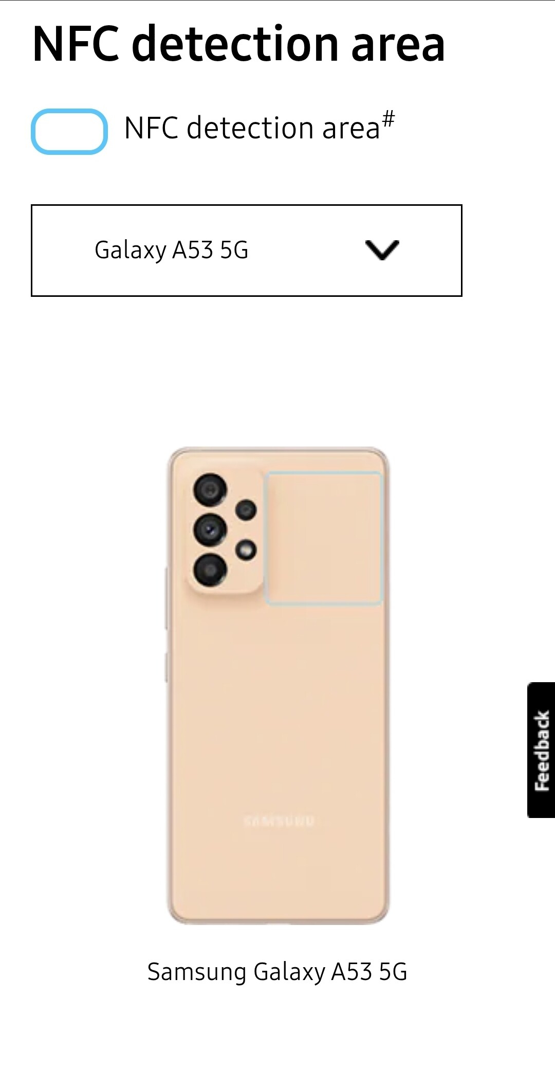

That’s a great find, I’m pretty sure I have a Samsung A53 so I’ll take a look for it.
Still a bit new to RFID and could be wrong, but does this picture show the antenna on the right? That aligns pretty well to where it scans my tags best normally so should be it.
It looks like an NFC antenna, it quacks like an NFC antenna…
Looks like the antenna to me!
Not every phone has the teardown and chip ID unfortunately, so you may have to do some searching around.

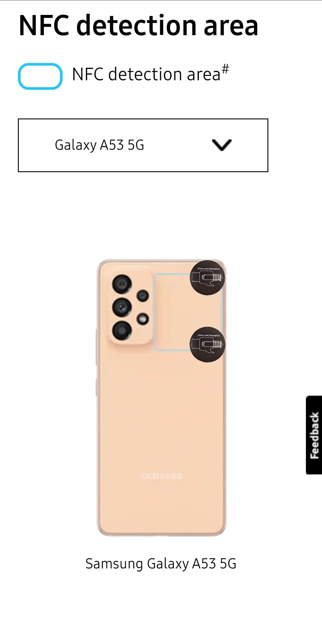

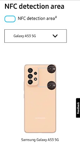

And yep, I rarely accidentally read, even with my antenna being closer to the middle/upper middle. (zFold 6).
Let me know if you have any further questions and I can certainly try to help, but there are tons of people here more knowledgeable than me :wink:
If you are looking at repeater stickers from Hammys Shop, Here would be a couple of good options for placement
The field detectors really help to optimise their placement
