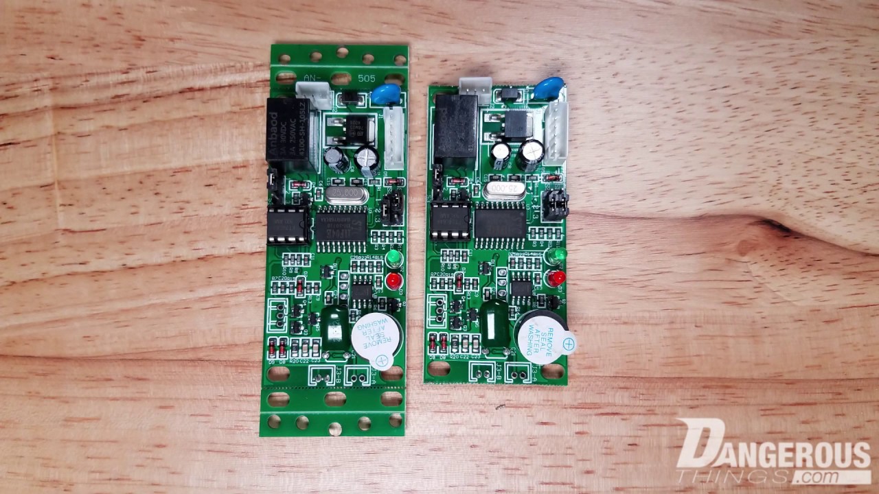

Part of the fun of hacking is making your own solutions. One of the ways we enable you to do that easily is with our xAC v2 Access Controller. It is a special 125kHz reader with additional memory and features on board that allow you to add chip IDs to a list of “authorized” chips, and a relay on board that can trigger external events like open a garage door or special project box or even a customized tool box.
Your imagination is the limit!
Here are some videos that explain the xAC and an example of what’s possible.
