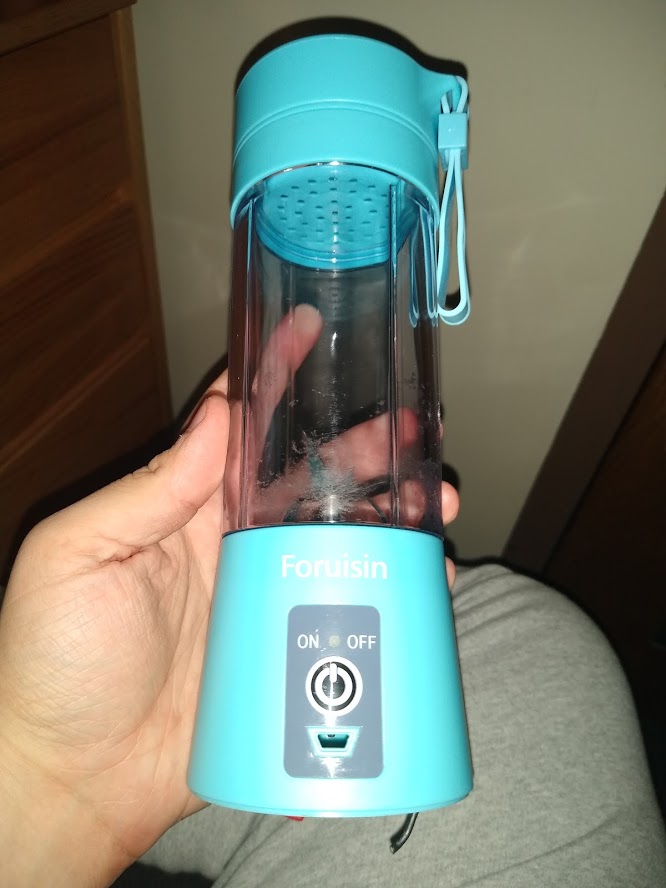

I decided to go with a $2 chinese Arduino Uno with a PN532 as the core of the build, attaching it to the safe solenoid via an N-channel MOSFET that I harvested from a cheap USB rechargeable blender. I needed a way to drive the solenoid somehow, and the Uno itself couldn’t provide enough current (plus the solenoid wanted 6 volts). Since I couldn’t use my hot air reflow station and the back of the MOSFET was soldered on, I decided to just cut the blender board around it. I also added a 210 ohm resistor to the gate connection to stop it from drawing too much current from the Arduino.

Here’s the poor remains of the blender that sacrificed its life for the safe. It was a pretty bad blender though, no real loss.
