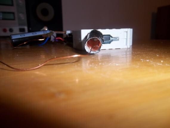

SO, I DID IT AGAIN!
I used this stepup converter to charge camera flash capacitors
A circuit breaker to short the capacitors to the coil
This is the coil
The tuning of the coil took ages because i dont have equipment to measure the resonance so i had to calculate how a spool with x dimension would behave and then wind it like that - and then it didnt worked for a long time because i could just not verify how the tuning is…
in the end it worked out and i was able to zapp two glass chips with it
the capacitors were just shorted to the coil after charged.
i burned through a whole lot of switches until i had the idea to use a circuit breaker for it.
based off my calculations the coil had a resonance of 14mhz but in the end i had no way of measuring it so i cant know.
after sending my results to satur9 it told me that my coil had probably 10000x too much inductance but it worked anyway :sweat_smile:
