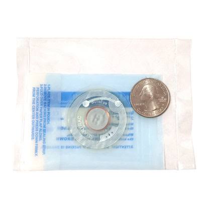

Brady temperature sensor NFC labels
I’m sorry, @Cribey, I will have to disappoint you. I requested the samples from my local distributor, but they checked and they only deliver to companies (which I am not), so they declined. So I won’t be getting any unfortunately. Perhaps @B4db0ycs is willing to share? :stuck_out_tongue:
From italy? Lol
Would you be so kind? I can of course pay you for the postage. How many did they send you?
I only received 3, so I don’t think it’s worth it to send you 1
Okay, thanks anyways :stuck_out_tongue: did you write to an Italian dealer? I’m just really curious about these and will try my luck again.

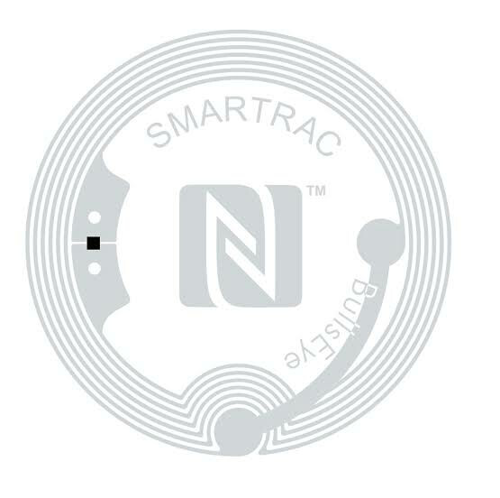

They look very similar to the construction of the Bulls Eyes
Which were converted into the FlexNExT
A great idea, unfortunately the fragility of the foil antenna was not robust enough to be used reliably for any significant period of time.
