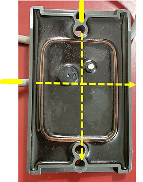

depending on where the antenna is placed,
plus the “duty cycle”/ pulse ~~frequency`` cadence
and the power of the reader. ( I see Amal has mentioned this above also )
These will all affect your results.
I have mentioned it in other places but I find a swipe method FAR more reliable than simply presenting, once you learn your best approach, you should have better success.
I’m not saying this is the specific answer for your situation, but it MAY give you a clearer idea of what is going on :man_shrugging:t3: and a couple of things to consider as you fault find.
What was the cloned card? A T5577? a combination?
TO me this sounds like it is close, but not quite getting a read.
As it has been 2 months+ I doubt it is swelling.
Have you had a chance to try out the LF Keyring xFD? Did you find some orientation that was brighter than the others?
I thought I would add this in for some more clarification
