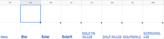

Chip compatibility matrix - Google Sheets

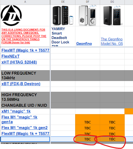

Update 1: also under the FlexMT HF, there are two random TBC in that row.

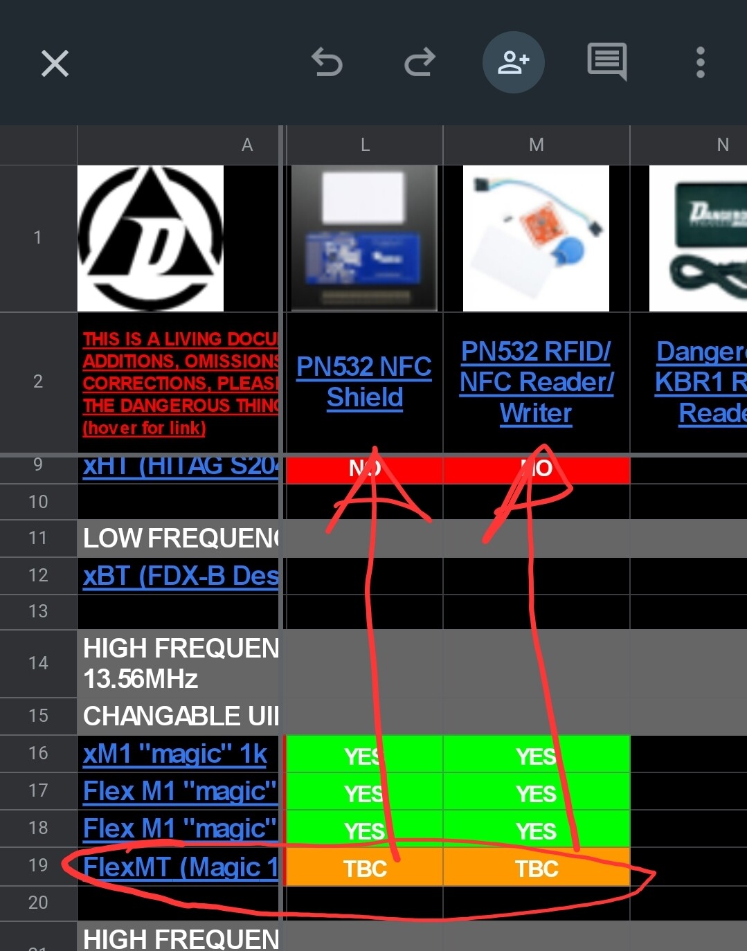

do you mean this?
If so, thats because theoretically they should be compatible, but they have not been tested.

No, this:

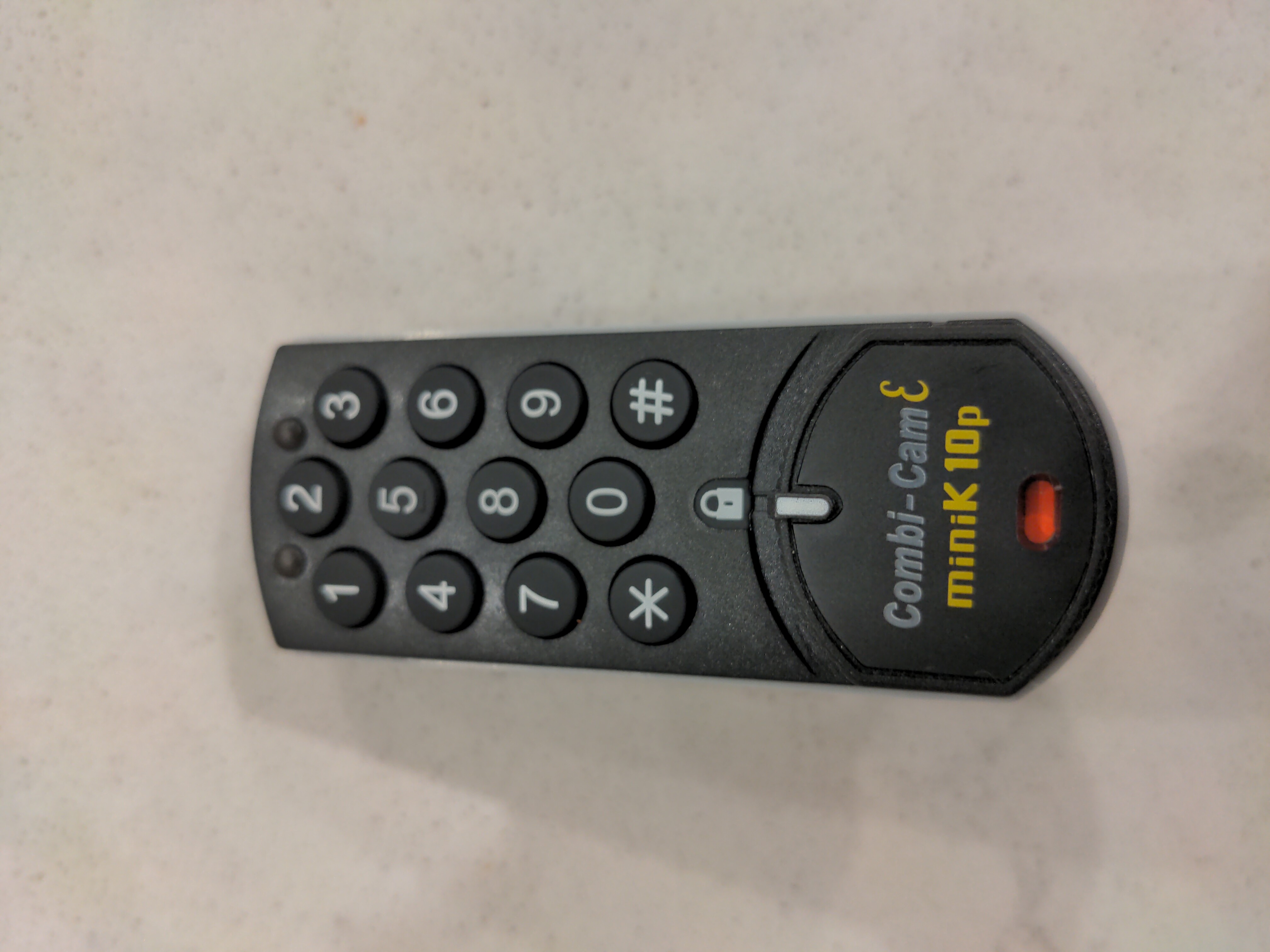

Anyone else having any luck with the Combi-Cam E miniK 10p? I purchased one directly from the manufacturer’s disbributer. I haven’t been able to register the T577 on my NExT. The Combi-Cam does work with T5577 tags I have on cards. It seems like the Combi-Cam’s reader is not strong enough to read my NExT.

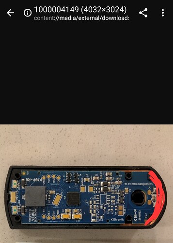

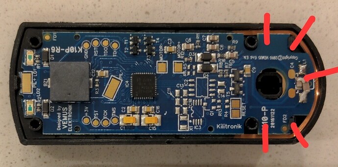

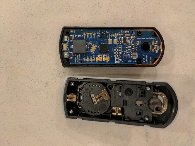

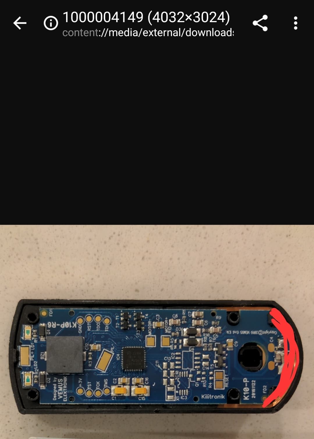

I took the Combi-Cam apart and can see that the antenna coil lines the entire outer edge of the Combi-Cam. I can look at it with a flashlight and see the coil running from top to bottom. I tried to remove the pcb board, but I’m afraid I’m going to snap the plastic tabs holding it in place. The tabs don’t bend. I came at it from every angle with a flat head screw driver and thin bladed knife. It doesn’t look like I’d be able to reposition the coil anyway. It’s laying along the outer edge of the plastic Combi-Cam shell. I then tried to get a reading with the xFD and diagnostics card along the outer edge. No luck with that either. I did discover that a normal tag can easily be read from the far left side of the Combi-Cam shell.
Still no luck with the NExT.
I’m guessing this Combi-Cam has some different hardware that doesn’t read as well as others of the same model.
@turbo2ltr’s video was the reason I was interested in this. One thing I notice is that he is able to lock the Combi-Cam without holding his hand up to it a second time. I have to hold a tag up to the Combi-Cam a second time in order to turn the dial to the locked position shortly after it’s unlocked. I haven’t found any settings to duplicate the way in the video.
Hmmm, the antenna placement looks pretty good, and thr plasic is only a couple of mm thick.

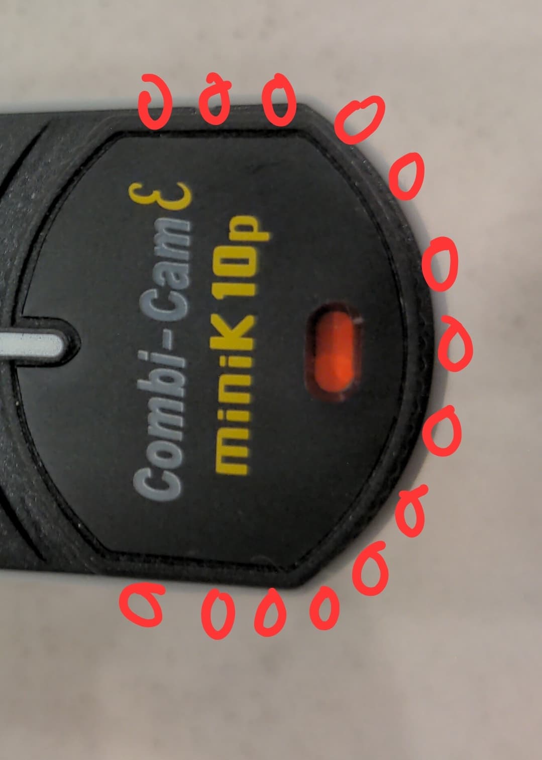

I havent asked about the duty cycle, but if you cant get your Feid detectors or diagnosti. card to light up, that is a little more difficult

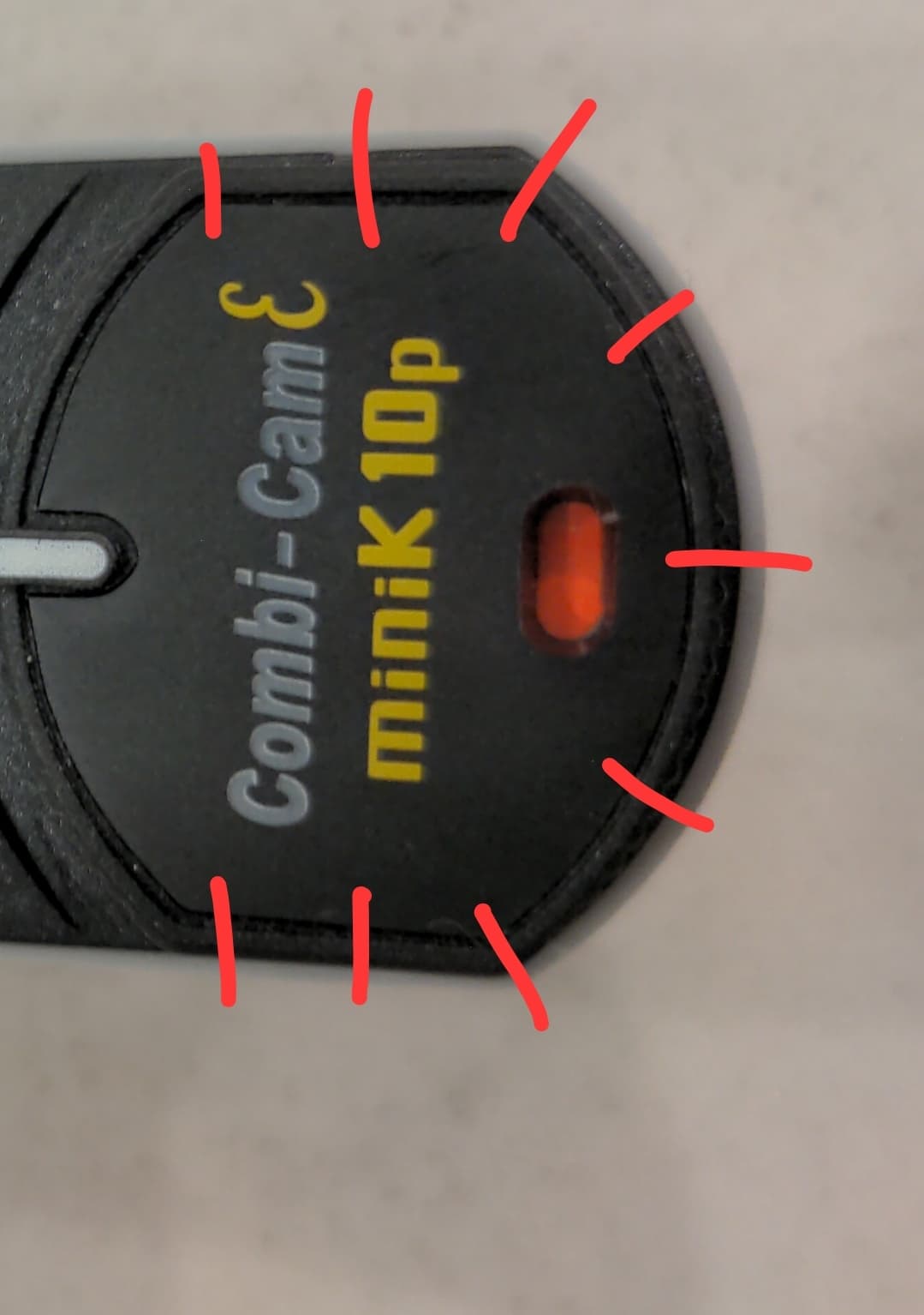

I would be looking at presenting over the antenna like this
This may be the easies place to present
I would try vertically
And horizontaly

For my own interest, this simply unlocks it a second time correct.
Not
first swipe unlock
second swipe lock
It is…
First swipe, turn dial, unlock (immediately locks in unlocked position)
Second swipe, turn dial, lock (immediately locks in locked position)
