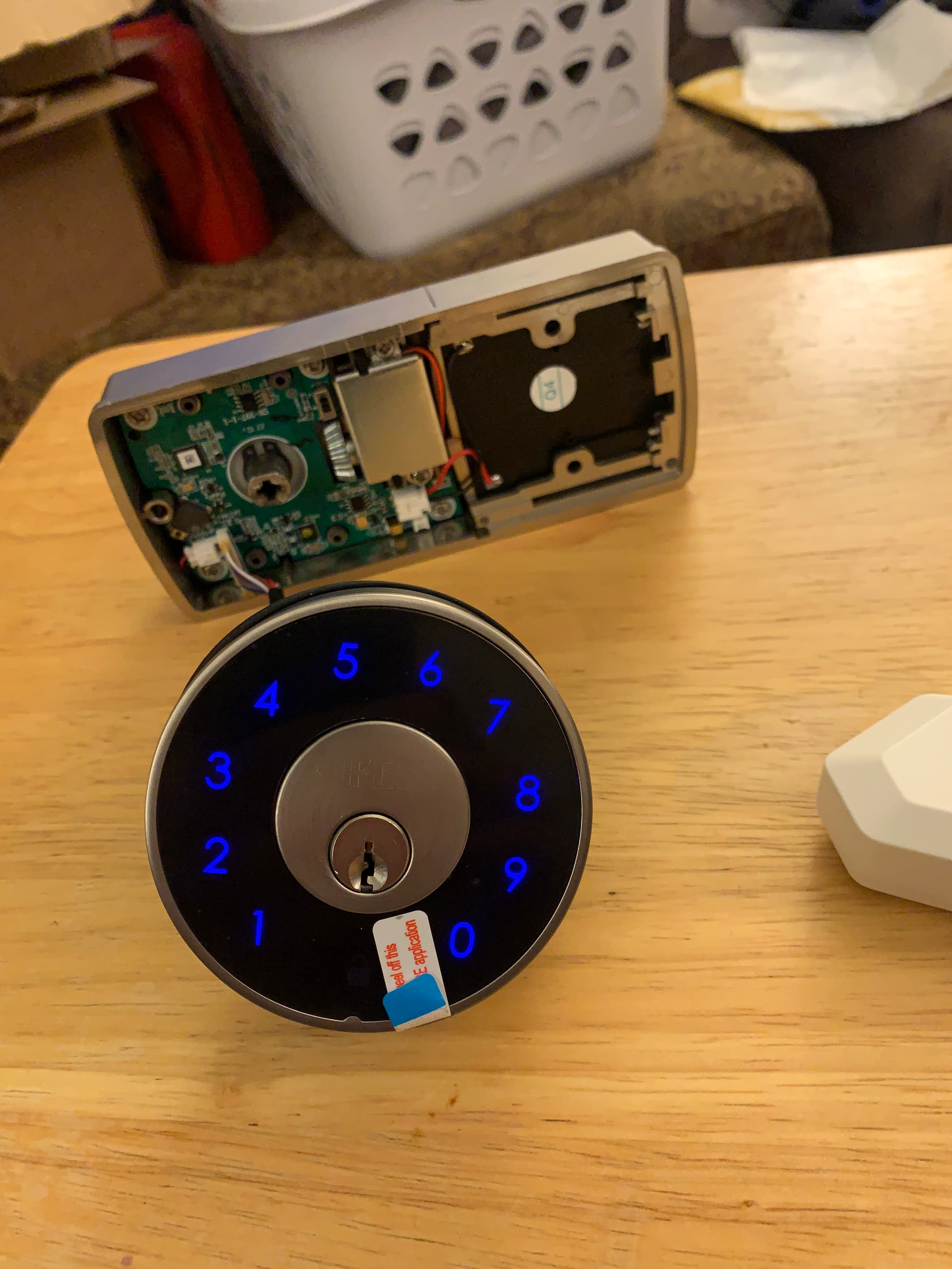

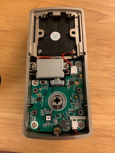

The Sifely deadbolt is confirmed to Not work with inplant size tags… I’m too ADHD to do a full proper review… hard to follow and talk about all the pros and cons and nuisance once I know it’s pointless
It will accept anything 14443a such as a ntag, mifare classic, or mifare ultralight/ntag I2c, so that’s kinda good
I used a flipper to emulate those tags and the the lock will open…. But the actual implant size tag nothing
I even tried a (non implantable) flexNT2 which has some sweet read range… and zilch
It even struggles with the included mifare keychain fobs, needs to be almost pressed into the lock to work
I would tear into the keypad to try to see the pcb… but I intend to return this, so I don’t wanna mess anything up

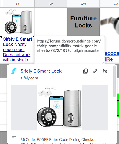

Added to the Matrix ( even though it doesn’t work )
I wonder if it would be better to have a separate sheet for non compatible smart locks :thinking:
I just figured you’d red no box it like elsewhere in the matrix
I like everything in one list just so I can search. And not working is very good data to have and should for sure be on the list.
I’ve done that, but the implants that haven’t been tested, really should have an orange TBC, we are only assuming the others don’t / won’t work, same reason as the orange in the green columns, I don’t want somebody buying a lock on the presumption that it will work…

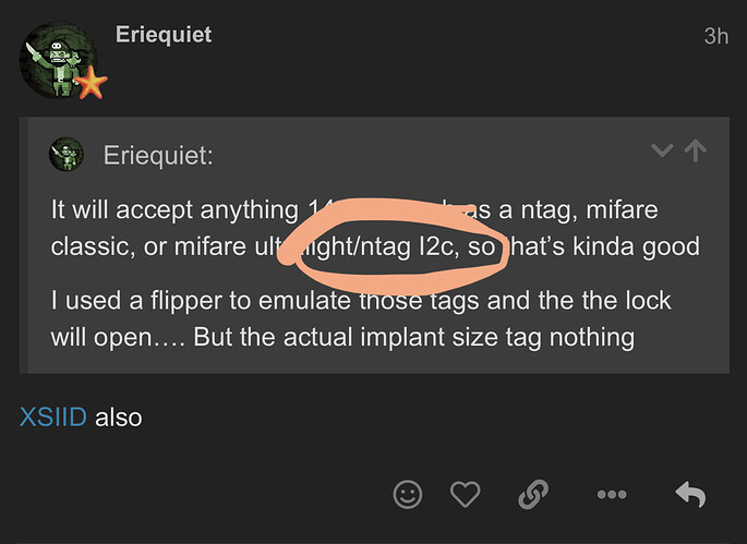

Ah, THAT’S better, thanks, I can’t add 'em if I don’t know what was tested.
I can update the matrix to reflect that, and can TBC FlexM1, flexMT etc
XSIID also
