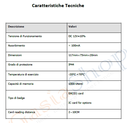

i am not very experienced, if you want i will turn over the pdf that was attached to me by the seller, i had bought it at least 5 years ago and used it with blue tag tokens. other than the pdf i have nothing else in my hands now.
Tastiera RFID Manuale.pdf (4.2 MB)

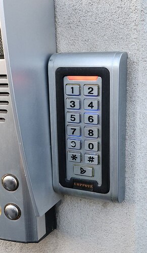

I tried the last access control I had available and it works without any problems as well, again with NEXT Rfid:
this access control

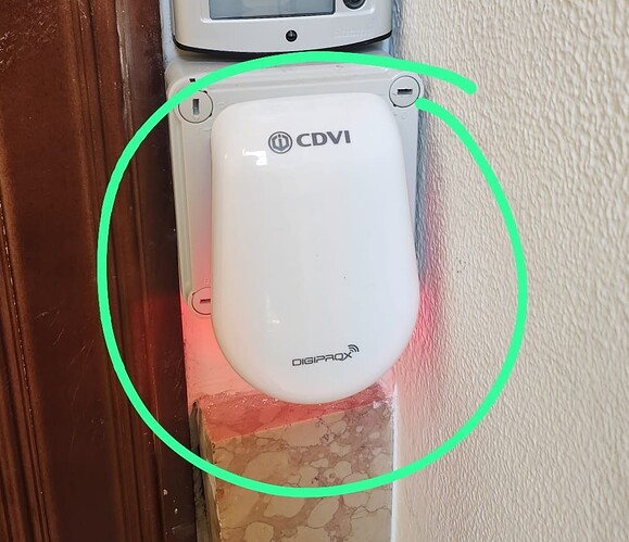

everyone, in the company I have this badge reader:
since a few days i installed the NEXT chip, if i pass it, it doesn’t even blink error, is this normal ? i thought it was compatible, the badges we use are HID.
if I pass the DANGEROUS card it shows me correctly with the led that it is LOW FREQ.
the IT person would also enable my “new badge” but if not even blinka error he thinks it would not work.
can anyone advise me on anything ?
thanks
This is likely your problem, we normally tell people to wait at least 2 weeks before expecting any sort of reliable reading and writing.
So wait for 2 weeks and try again, the let us know how it goes.
Basically, everything else sounds good
Try your LF xFD
:xfd:
see if you can get that to light up!
If so that is very promising, but a concern I have is the “bubble” design of the reader, so I hope the antenna is not burried to deeply.
If you could get one open to take look, that would be great.
Alternatively, if you do scan it and get denied, that is a great sign that you can get it enrolled.
Long story short, wait 2 weeks and try again
my NEXT chip is working perfectly as I had written a few posts ago, it opens 3 kinds of access readers for my home gates.
is this one that is not even being read.
the RFID diagnostic card lights up as this reader passes through, but my chip, it does not make the reader make any noise.
