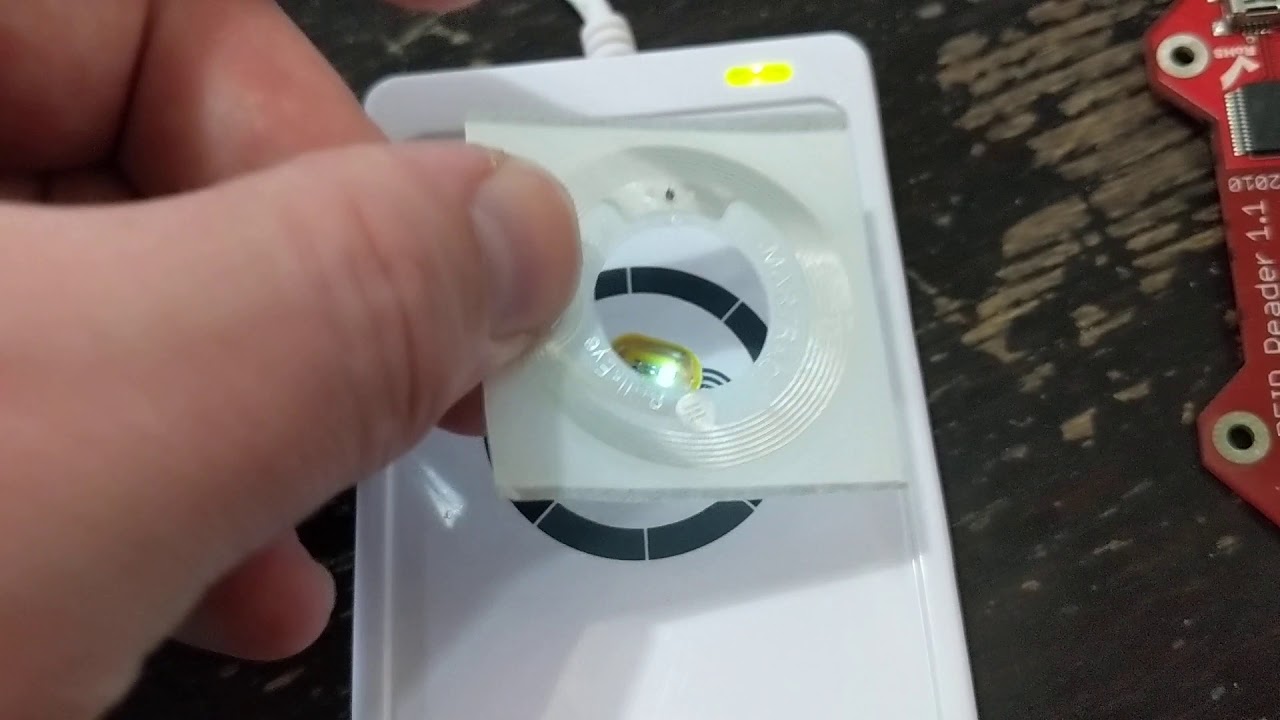

The more I look at this, the less I think this is a good idea… the polymer will have weak points around the center disc… I think maybe at best one might achieve an off-center approach… something like this…
That would offer a large re-attachment area and the most stability for the center disc… and it shouldn’t affect performance all that much at all… in fact, prelim testing with me just holding it in place shows no significant difference in performance of either tag.

Is the sticker basically boosting the field for the led? Mine won’t light through my hand…
I can also overlap them a bit, but yes overall performance is about half of that with the NFC tag surrounding it… I’ll explain why in a minute…

Well, sorta… basically it’s reshaping the magnetic field a bit and making it go where we want it. The larger size of the NTAG216 antenna is causing the field to reshape around it, forcing flux lines through the center at a much greater density (if you can think of it that way) than without the larger antenna being there.
If you had an NFC nail (flat plane spiral antenna) inside your hand, and you placed a larger antenna around it from an Bullseye tag (cut out the metal foil NFC logo from the center first), then you would see the same effect.
