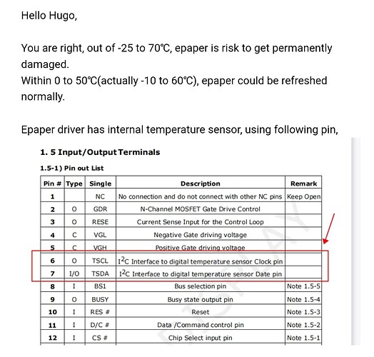

I got a reply from the seller, seems that what I originally thought about the safe operating temperature range is correct. The display can be changed between -10°C and 60°C actually, and will damage if it reaches a temperature above 70°C.
ohhh, those are great news!
By the looks of it, should be safe within the body (as expected).

That said, there are still a couple questions unanswered on this topic:
  • How would the implant itself behave to the external heat? i.e. will it heat up faster than the body can regulate the skin? will it absorb heat like a sheet of metal would?
