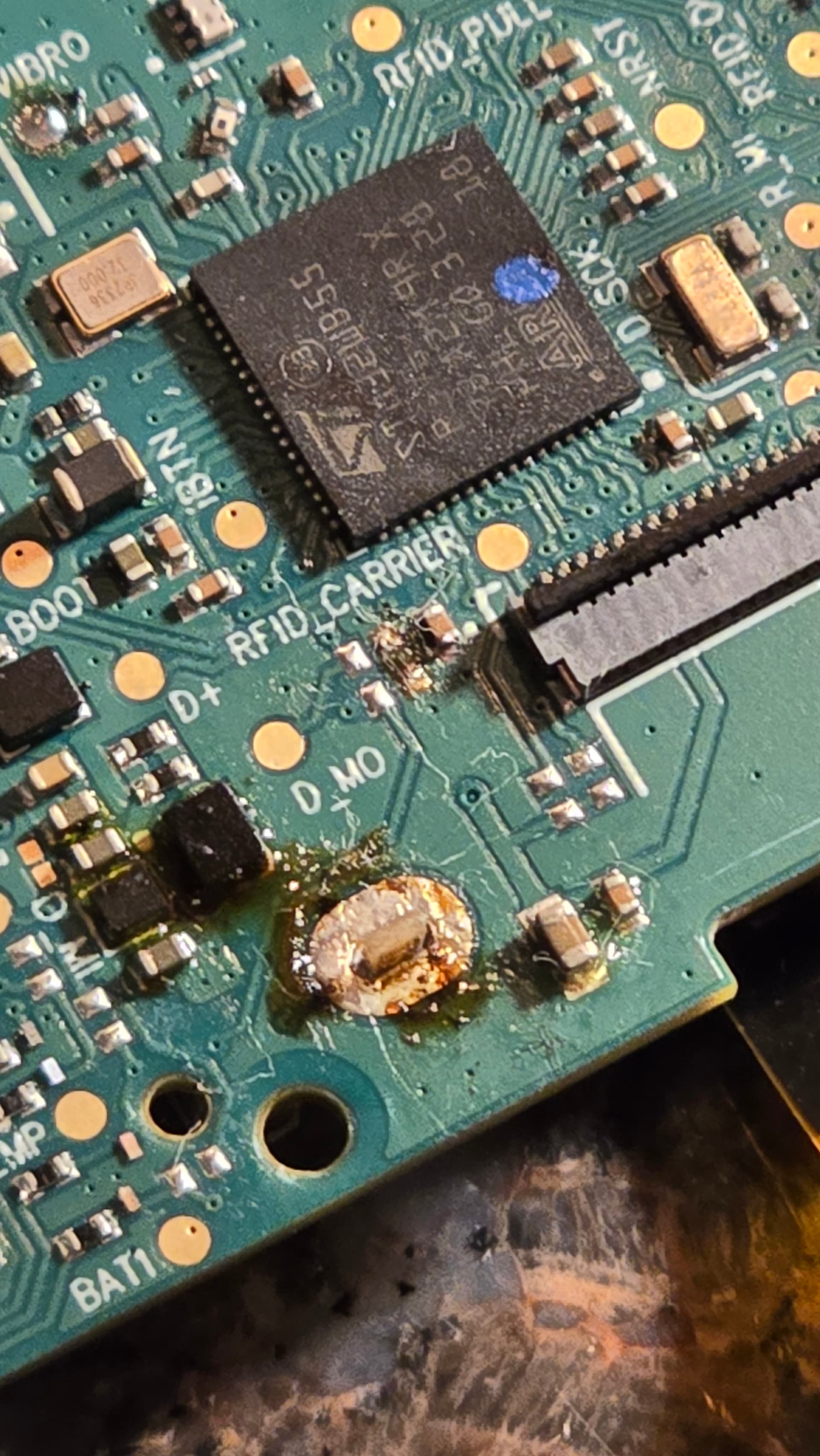

I did a full wipe on it, formatted the SD card, factory reset, installed stock firmware, then Xterem via Qflipper. Turned on lights in settings, no go.
I do appreciate the offer. I screwed it up so I would not want you to send me a new board and cover any costs. I’d feel bad about that. If anything I’ll send you my flipper and if you can fix it awesome, I’ll pay you for your time as well as order one of your wifi boards, pre-assembled ofcourse :slight_smile:
If you can’t fix it, keep the flipper, I’ll buy an RGB board and wifi, and just order another flipper and try again. Or just keep it orange.
As for the damage to that connector, I was using the heat gun and went to look closer, didn’t pay attention. So far everything that I use my flipper for seems to be working so I think that is okay.
It doesn’t look like it caused any big damage.

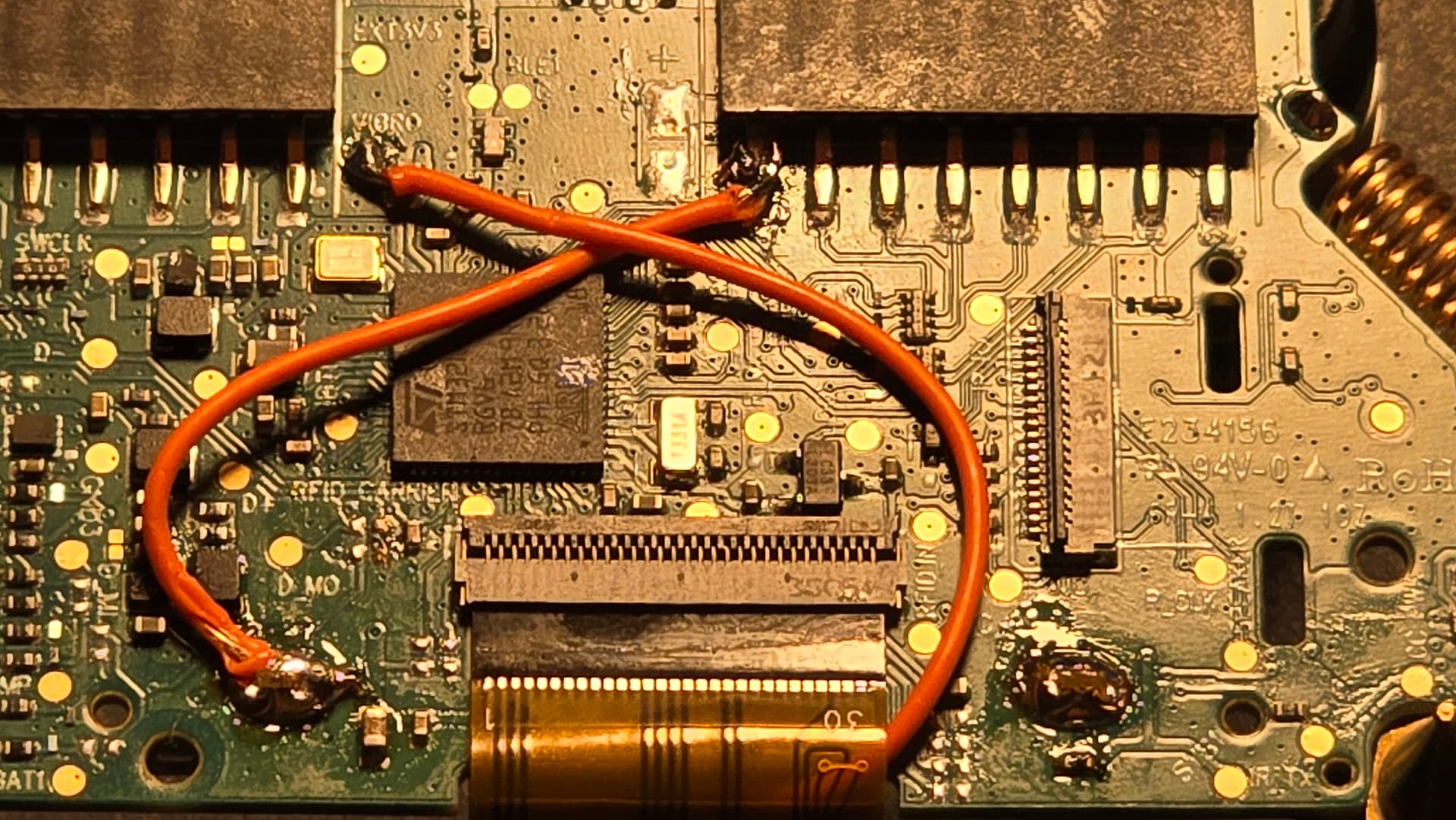

Received @aw9d flipper today. He did everything right. The board was even in good condition. Best i can tell from the documentation was that somewhere along the way an internal fuze was popped and the positive terminal no longer received power.
The above post i mentioned another person running a jumper from the 3v3 pad to the positive terminal of the RGB board was the proper fix. Running the jumper and turning the flipper on and it popped to life. Screen times out as expected and everything works perfectly.

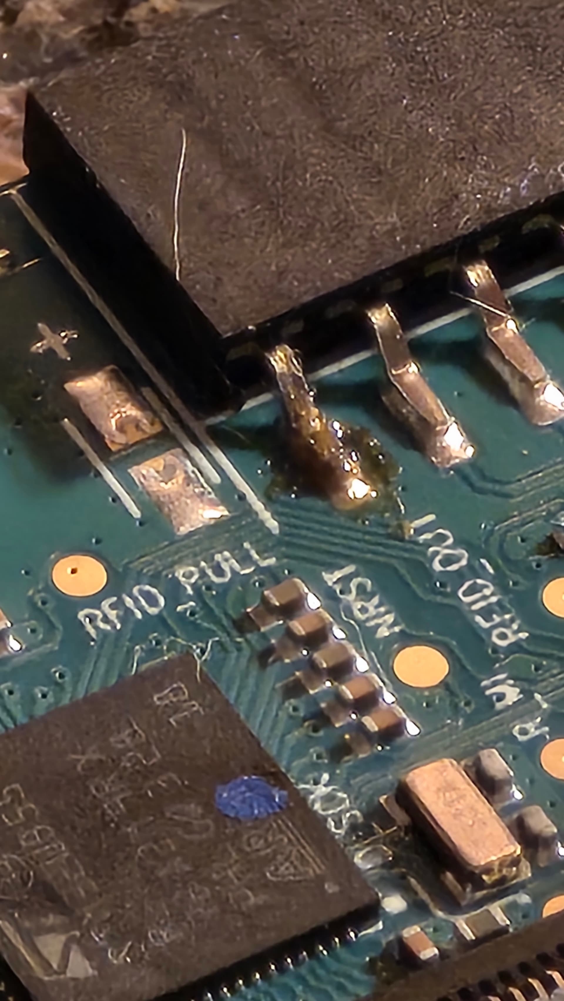

I’m having problems. I can’t get my wires to stick to the solder pads.
It’s brand new solder too.
I can even get anything to stick to the gpio pin.
Few tips:
  • clean the board with qtips and 92% (or higher) isopropal alcohol
  • use flux!
  • make sure you’re applying enough heat to the board.

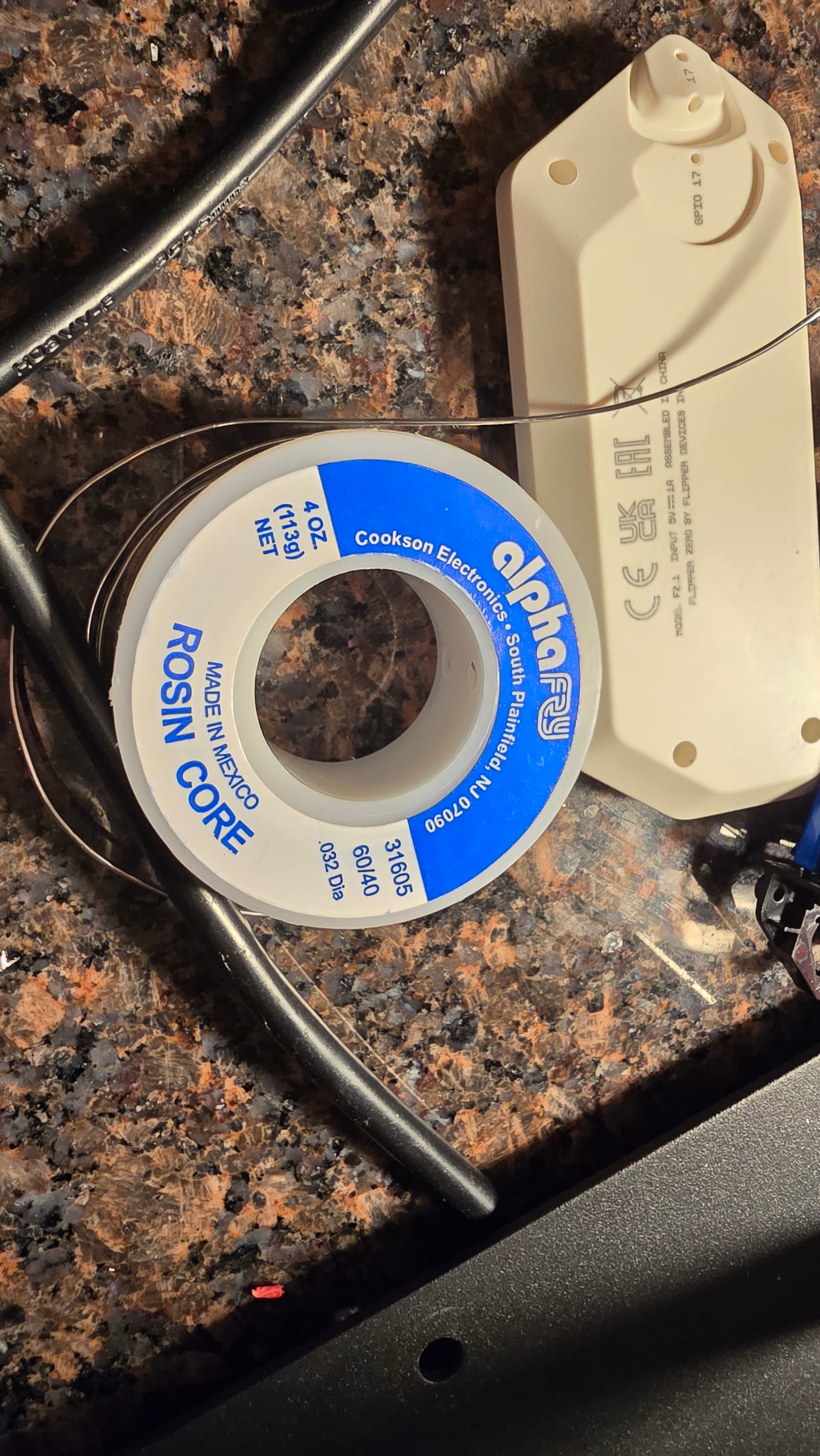

  • you’re using leaded solder. The board is almost certainly using lead free. I would recommend trying a good quality lead free solder. Lead free solder generally requires a higher working temperature to flow properly.
  • any pin that is connected to ground will require a little more heat than other pins, becuase the ground plane is usually a large sheet of copper and thus will take more heat away from your solder point

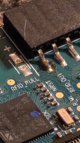

Ok, I used the isopropyl and cleaned stuff off. Used some flux and turned up the temp on the iron and I got some to stick!
It’s not pretty, but it makes the connections.

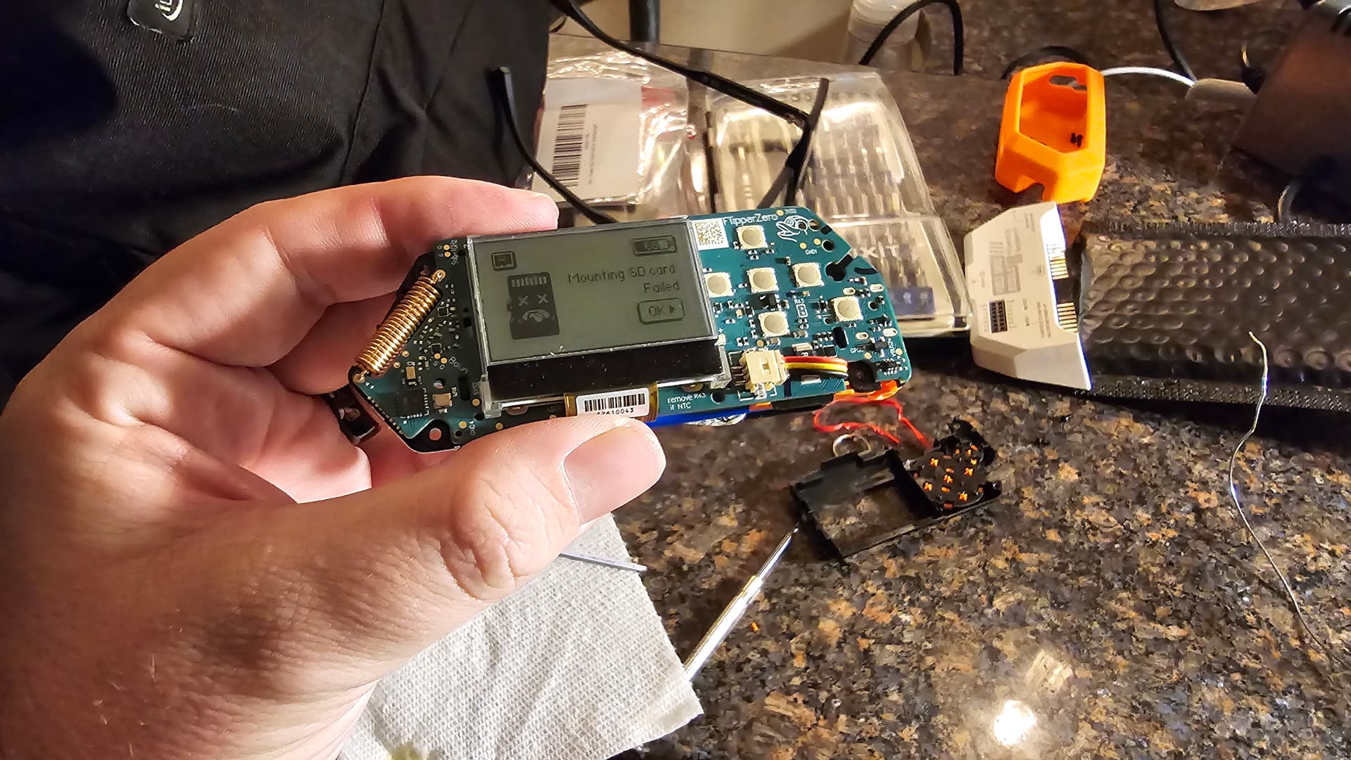

However, nothing is lighting up. And the SD card slot no longer works. Ugh…
best guess is you’re unintentionally bridging some connections. Are you sure your solder joints aren’t touching any other components?
