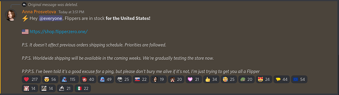

Are you still waiting on yours?
hmmmmmmmmmmmmmmm
I know they said “It doesn’t affect previous orders shipping schedule” but that still feels a bit shitty.
okay. maybe a lot shitty.
They did post this though:
Already gone so nothing to worry about lol
But yea… not a great look
I would have waited till everyone has theirs before doing anything… but I’m no business wiz… maybe they needed some quick capital?
I’m sure they aren’t super profitable at the moment

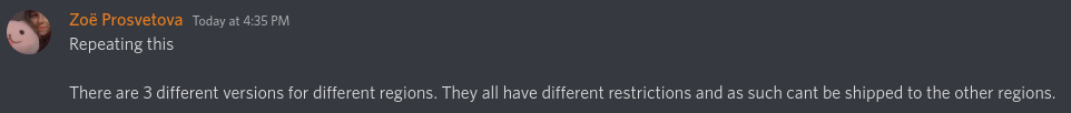

Dam … They’re available for the US …
If it’s in stock do it,
I might have mispoken, it says unavailable but it will let you add to cart so maybe it’s just not updated text
