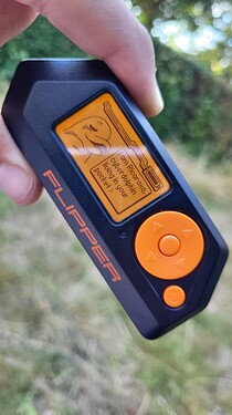

My Flippers arrived too now!
Now i also tested 125kHz Transponders and so far it doesn’t read alot. It doesn’t read Hitag 1, it doesn’t read EM4450, it doesn’t read Hitag 2 pw, It doesn’t read Hitag S, But it does read EM4102 cards with a range of 4cm and it does read the T5577 implant (xEM) with a Range of about 1cm above skin. With the Tags that didn’t work they are simply not implemented yet as far as i know but they plan to add them in future Firmware Updates.
If you have any transponders i should try to get my hands on and measure the reading distances/ reading performance of i can try to do my best to get them and try them out.
All in all i absolutely love my Flipper Zeros! Ghey are just so handy and fun to work with all the wait was really worth it! :3
