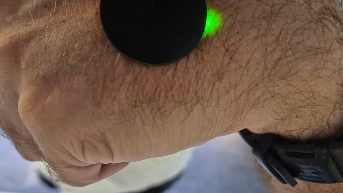

This is more difficult to assess, as it is a light and not simply when it reads like RFID, fortunately, the leds seem to go from off to on with very little middle ground, so the on is where I took my readings.
Once the LED was illuminated, it just got brighter the closer they got.
Long story short, all devices i tested illuminated ~5mm
Here are some photos
As you can see, they are pretty bright, all photo’s were taken at 0mm

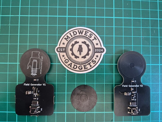

Just some more photos of the V1
Side by side of the V1 and V2
This is the new V2 design with all surface mounted components. Works great but will also include a free repeater sticker to increase the range even further.
*Due to shipping requirements these will ship without a CR2032 battery
