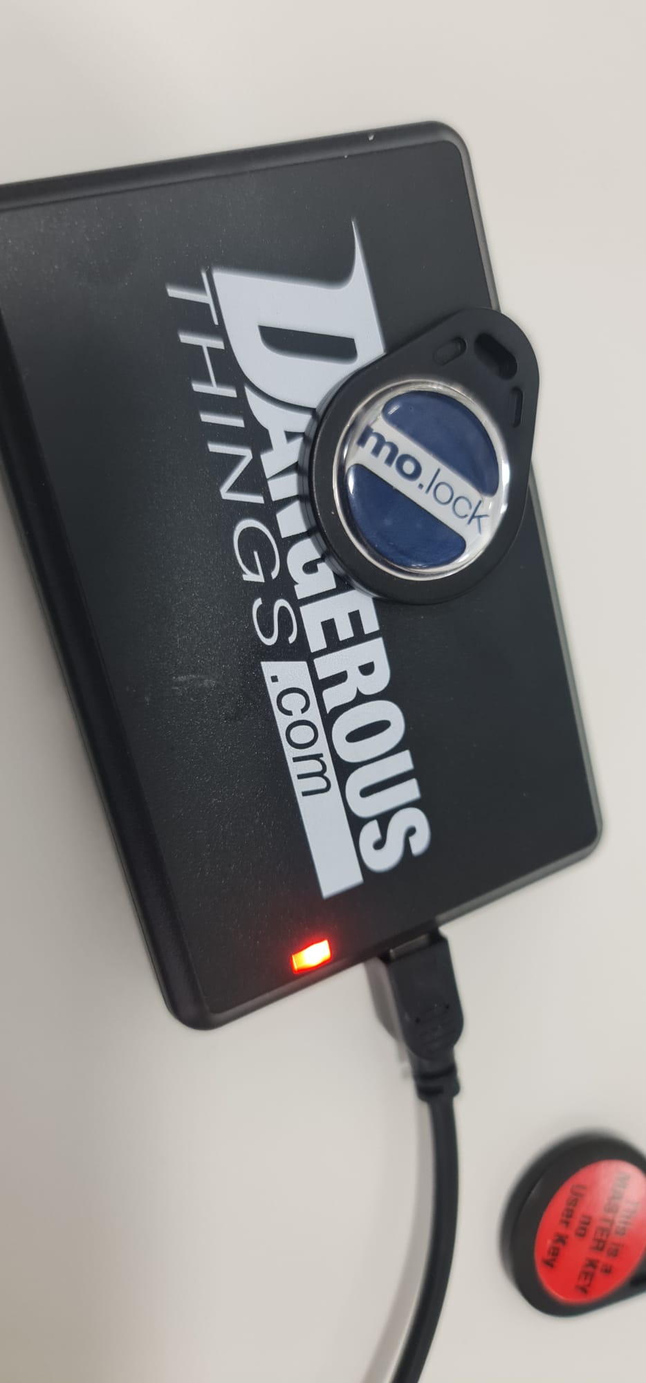

This reader is a basic reader it works like a keyboard HID (Human Interface Device) keyboard.
Plug it into your Computer, When you scan your NExT the “keyboard” will output your NExT (xNT) UID onto the current text window.
People sometimes use these to unlock their computer
