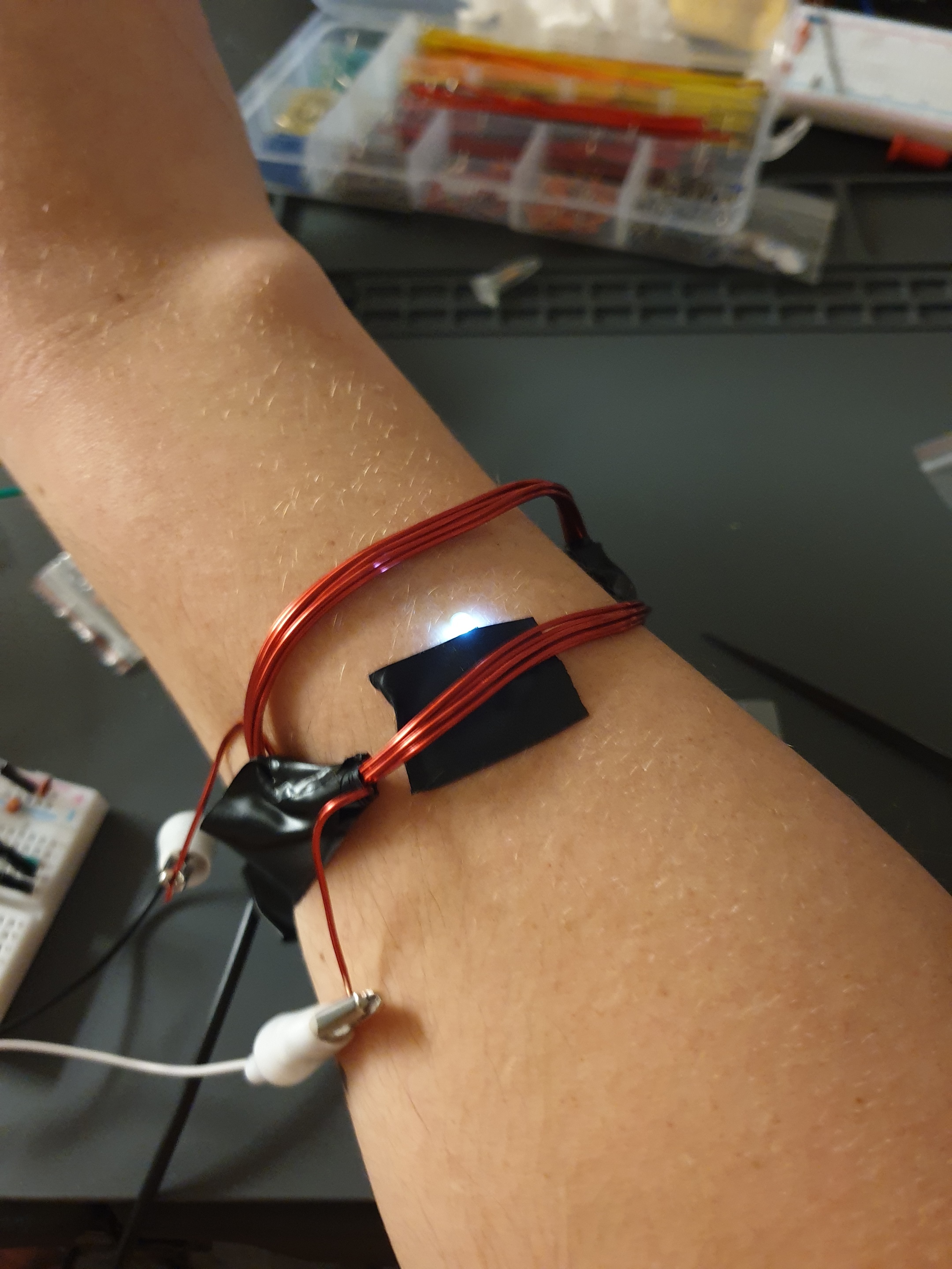

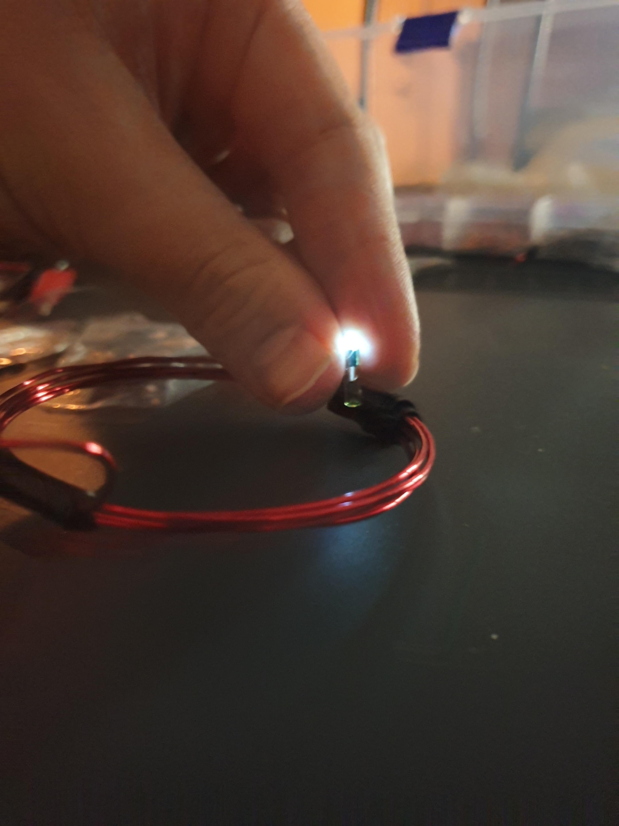

So the resistors in that circuit already drop the voltage enough. I must have had it miswired when I burnt out the transistor before.
Jacked the voltage up and tada!

Hanky as fuck but itās kinda a braceletā¦
I can move the xLED about 1/4 of an inch away/deeper (so same location as in picture but inside my arm) and still get a fairly bright light.

At this point we have a working POC. Obviously it still needs lots of work but I feel like we need to work out some constraints so we can start looking into how to optimise the solution for those constraints.
For example I was pumping ~6W into the circuit (30v @ 200ma). Is this too high? How are we going to power the system?
What is the minimum useful range?
Is it okay for the coil to āframeā the implant?
Do we need to mount everything to the bracelet or will we have to externalise some things? For instance a battery in a pocket with a wire running up the arm?
Input from anyone who would be interested in using one of these would be valuable just to get an idea of use cases etc ![]()
For my case, I think I would put the battery packs into one of those arm sweatbands, so I could wear it as close to my shoulder as possible, with the wire coming down the inside of my arm. I donāt plan on wearing it daily, so I can tack down the wire with a bit of tegaderm along my arm.
It would be great if we could minimize it to the point that we could use a few coin cell batteries and keep it all on the band. The band could even be a transparent plastic so you really canāt see anything but the coil and circuit in a tiny case. I think the only way to do that would be switching to 125kHz and making a small ferrite core coil with tons more turns. Weād have to use LF xLEDs, though
I do have some parts coming for a 125KHz circuit. Also I think it would be easy to get a microcontroller to output 125Khz so you could have like a Morse code blinking implant.
