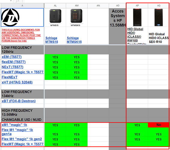

Ow okey , I based my answer on the google spreadsheet:
What is the “yes” for then if not enrolling or cloning?
There SHOULD be a link to a post where it was used, did you follow that?
Also it will depend on the software settings, If done strictly and allows HID only, it may not work, if opened to “Other” ISO14443-A and a UID it should.
