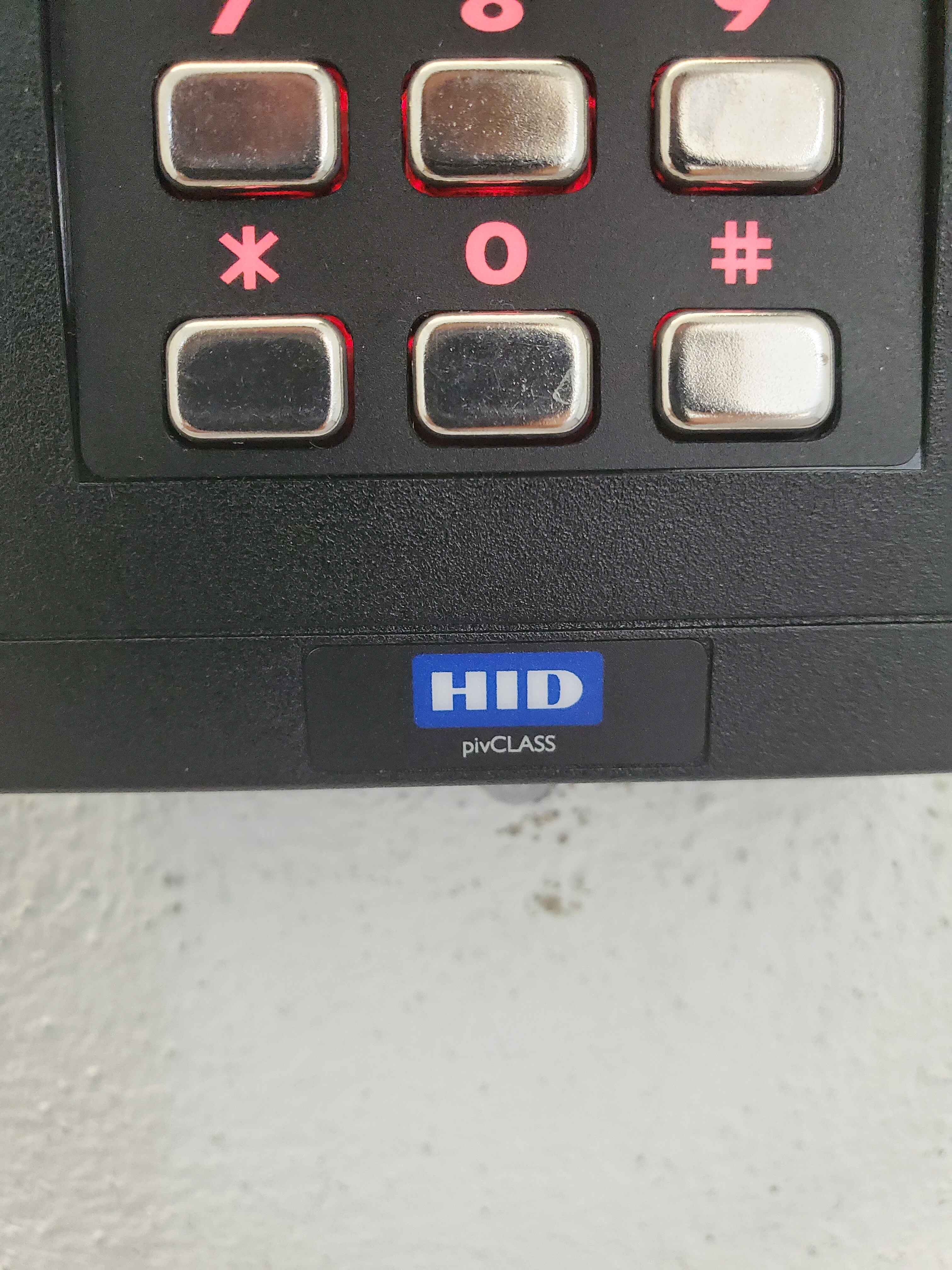

Site B
Reader
It’s a bad photo but I can get a better one tomorrow.
I believe that it is a pivClass RK40
When I use the RFID Diagonstic card only the 13.56MHz shows up.

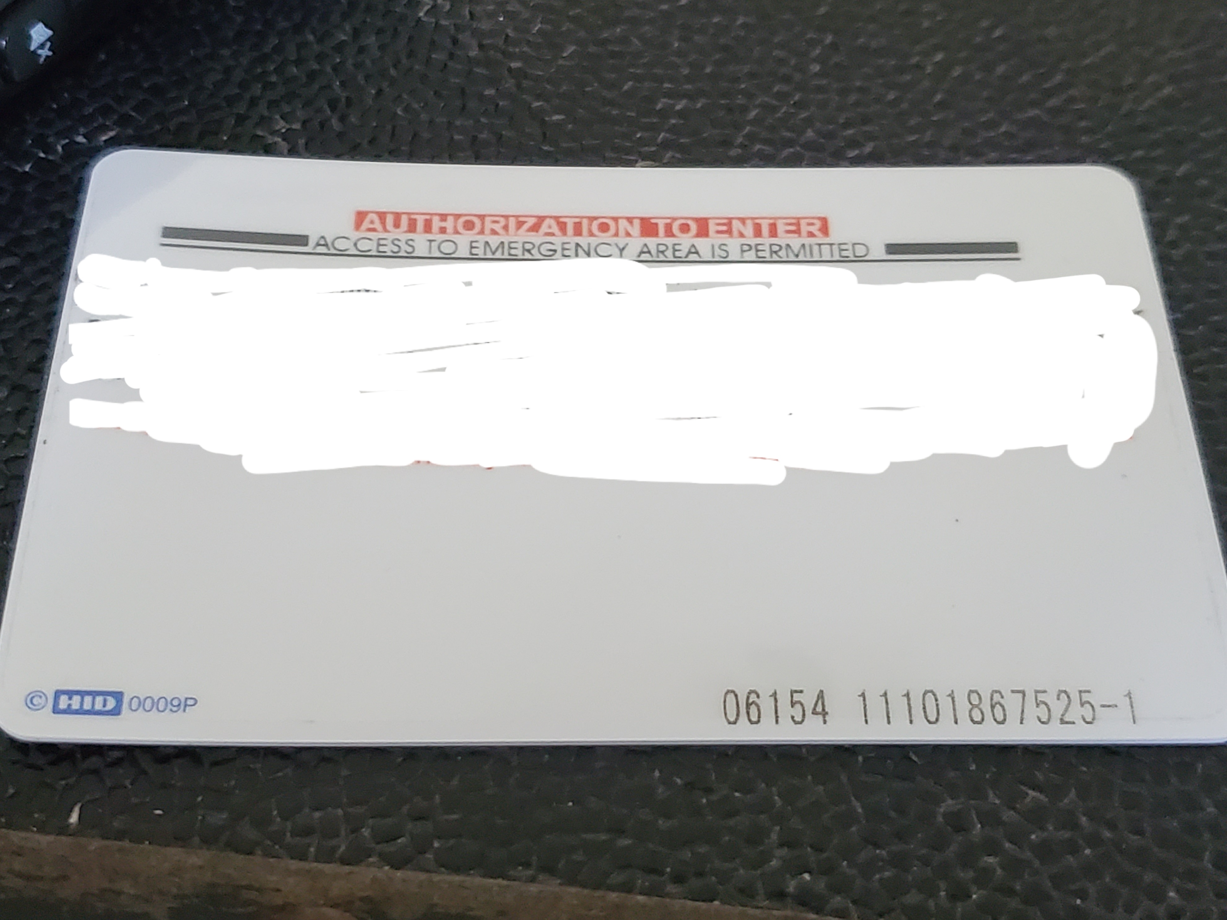

Card
They are both 0009p cards. I found
HID GLOBAL CREDENTIAL IDENTIFICATION.pdf (367.2 KB)
2.1
000 is 125kHz HID, Indala or EM Prox (single tech)
I also tried tag info on both cards and did not get a read on either one.

Because both cards didn’t read on TagInfo, and they both allow you access, they must be LF only.
Because both cards are labelled HID I am going to assume they are HID Prox.
Which your bluecloner can read/write from/to.
It is strange however that your LF LED on the Diagnostic card is not illuminating
and also that you could only successfully write the site B card.

So I tried it this morning and the low frequency light is not turning on at all, while reading my ID badge.
Update
Site C uses the same badge as site B
But different Readers
I get both a high frequency and a low frequency signal from the reader at Site C.
So I tested it with my badge and it worked…
SITE C READER
Unfortunately I’m still only getting a high frequency signal from the readers at Site B
