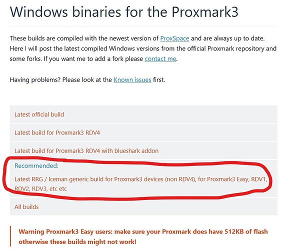

Thanks for the tips. But unfortunately non of them worked. The link in the one from the guy you mentioned doesn’t go to anything anymore. the one with the proxmarkbuilds.org link also doesn’t work because of an useless outdated link. and the last one has the same non working link.
This link at proxmarkbuilds.org does work and is the one you are looking for;
The build it links to is from yesterday
