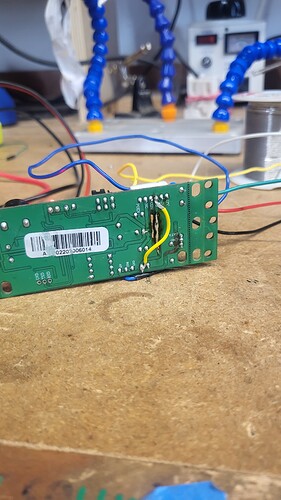

I misdiagnosed the problem… You removed the S3 jumper, right? It looks like you’ve got a burnt contact in the relay of the xACv2.
You can replace the relay if you’ve got the soldering skills or can enlist help at a makerspace but I’d just order a new board.
I’ll see if we have a relay on hand. My dc circuit knowledge may be rusty but I can still solder damn well lol.

@enginerd thanks for you help, got the xacv2 up and running again. Had the whole thing wrapped in electrical tape while installed in the car and when I fried it…so I never saw the giant burned trace on the back of the board connecting the NC wire on the wiring harness to the relay. The copper traces were in pretty bad shape, but I was able to repair the traces. They were still loose(still had good continuity)and coming up from the board, so I also added a back up jump wire between the two
All fixed!!! Here it is in action! Bonus I can lock my car with it if I keep holding the implant up to it. It uses weird logic with the way and duration the key is being turned, and for whatever reason continuously unlocking eventually locks it
I don’t really care why it works, I just care that it works

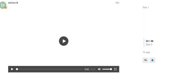

It’s probably just me, but all I get is sound. ![]()
Looks like this.
If I click on the play button, the playbutton disappears and the video plays all white, but I can hear sound. I can right click on the play button, and open in a new tab. But that saves it to my pc, which then plays with a solid black screen with sound.
And… it plays fine on my phone.
Some days, I’m just, Fuck Technology. I wanna bang rocks together instead.

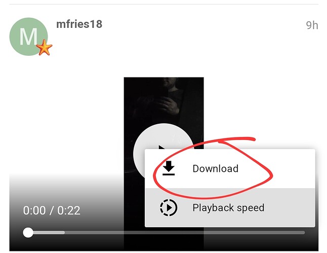

Might be a codec missing on your machine
Right click on the video? Sometimes there’s a download option
