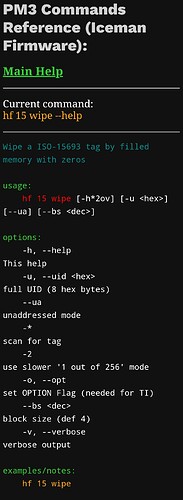

look at this:
As you can see i tried changing uid (which failed because it is no magic tag) and also wiping it. Wiping it does repeatedly not work, also in the 2nd slower mode.
Is this normal? are there any locks on it?

ISO15693 (NFC type 15) is a very broad standard, not every card can be rewritten or wiped, it appears this one may not be compatible with that command at this time

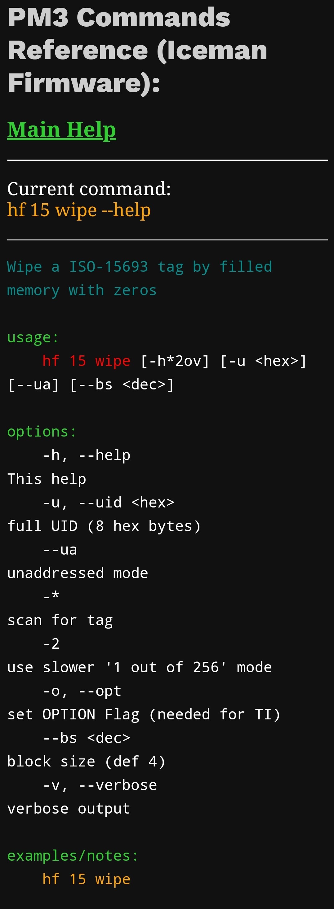

The only PM3 commands I can think that might work, are:
‘hf 15 wipe’
I know you tried that, but there are a couple of suffixs you might need :point_up:
did you try those
i.e. adding your UID?

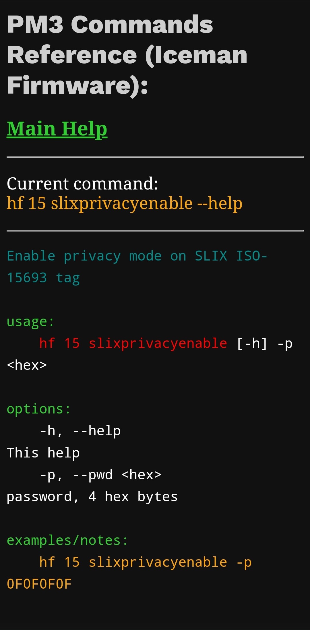

The only other option I can think that might work, but I havent tried it myself, is
My guess is, you set a password, and it won’t reply without the password being sent.
So that might achieve what you are trying to do…
:man_shrugging:
Maybe I’ve missed something, but what makes you say it isn’t being wiped? I don’t see any mention of the memory contents (other than the UID which is read-only) remaining after running the wipe command. You seem to have decided that “wipe” actually means “permanently disable” rather than “erase the user memory”. I understand it would be frustrating when the device doesn’t work the way you expected, but it doesn’t really seem like a shortcoming of the PM3.
Have you read the datasheet for the ICS2602? Specifically section 9.5.3.8 where it tells you how to use the DESTROY command? I don’t think the pm3 has that as a built-in function, but you should be able to send it using the “hf 15 raw” command.
