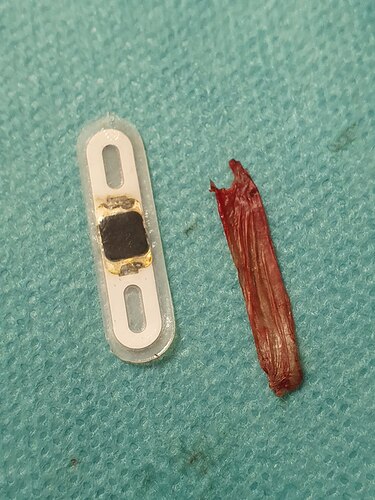

I had my dead Walletmor replaced today and it is video-documented (18+ and canāt be embedded). Working with a proper skin surgeon was great, even considering this was his first time working with non-medical implants, proper local anesthesia helped the process quite a bit it seems. However weāll need to work on the tooling, since the sterile flex āpushingā tool we had available was very far from ideal, hopefully he was gentle enough and everything heals and works properly, if not, heāll get a second try. Boring parts of video are edited out. Mute the sound or enjoy The Prodigy.
Also, can somebody please explain what is on right half of the following picture (dead implant post extraction on the left, its ācoatingā on the right)? Till now Iāve had the impression the whole transparent part is a single-ish pieceā¦

Additionally, the polymer coating is very robust, but very thin. If the flex device is handled with tooling such as forceps or tweezers or any tooling other than a sterile gloved hand, it could be punctured or damaged in such a way as to allow moisture to infiltrate over time and damage the internal encapsulated electronics.
It looks like the encapsulation tissue, the pocket the body forms around the implant over the first months to isolate it. But honestly I have never seen it come out with the implant like that ![]()
iām having a hard time understanding where this beef jerky stick came from⦠when the old one is pulled out, it doesnāt look as though itās coming out with the implant;
⦠unless was this something that was on the underside of the implant, obscured from view?
given the amount of stretching that guy did in your wound, he could have probably pushed his little finger in there just fine. the forceps he used to push it would have been fine if he had just kept the jaws closed and not gripped it⦠the blunt front face of those jaws is fine to push it into such a gaping pit ![]()
The implant was indeed completely encapsulated in the thing. And after separating it from the implant, it turned opaque as photographed quickly. On the Amals screencap, it is seen on the outermost part of the implant coming out, it was perhaps even more dense on the other (bottom) side. So encapsulation tissue, no possibility of this being some kind of implant coating / biopolymer layer? A surprise for parties involved nontheless ![]()

Yeah that crazy⦠never seen that before. Itās for sure encapsulation tissue⦠itās probably all the ripping and tearing with forceps⦠probably grabbed the tissue and pulled it out with the implant. I see some scalpel work going on so maybe they were cutting it away from the surrounding tissue because once you cut into the pocket, you can get inside it and grab the implant out without needing any cutting⦠so yeah probably cut the pocket tissue from surrounding tissue.
The fact it ādried upā basically in front of your eyes is also very interesting⦠definitely not any kind of encapsulation material we use would do that.
