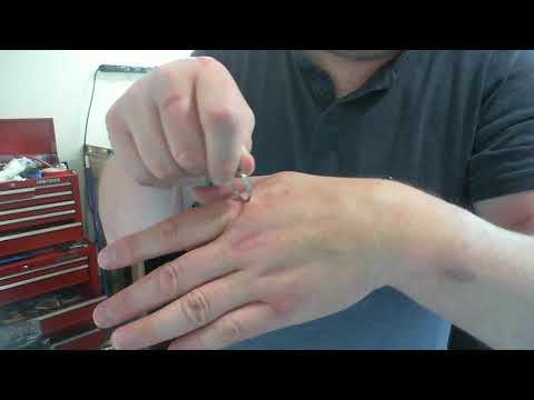

I’ve reviewed the video and yes this is a problematic installation. I will reach out to make contact with Charlie about it, but in the mean time you should focus on localizing the implant. Here are the options I can see possibly working;
  1. We send you an xAC v2 that you can use to “scan around” your hand to attempt to find the implant that way… even without programming it into the xAC, a successful read will result in “deny” beeps from the xAC. Using this approach you should be able to localize the implant.
  2. get an x-ray. The best way to find the implant is to get a full hand x-ray done. If you have insurance you should be able to explain to your primary provider that the injection of an RFID transponder like whats injected into dogs and cats, is not able to be located and you would like to get an x-ray to confirm its location. Furthermore, if you are having pain or lost range of motion from this, then the doctor will almost certainly agree an x-ray is appropriate.
Personally I suggest exploring both options. Please send me your order number and we will obtain your shipping details from that and send out an xAC for you to use diagnostically.
I would say there are a few problems with the installation that any professional who even briefly studied our documentation would not have done;
  1. the injection is not parallel to the index metacarpal. The angle is very strange.
  2. the tenting of the skin was perpendicular to the needle, which only gave a broader target for the needle point, but did nothing to stretch the fascia open separating dermis from muscle to give a nice open area for the needle depth to be controlled inside of.
  3. the needle was inserted, but not retracted before ejecting the chip. this means the chip must then force its own path through tissue as there is no pocket for it to be ejected into. this could result in deflection in any angle, possibly affecting final depth.
Overall its not a good installation. For review;
Agree, and the tenting was something I would have done differently for sure, but I just don’t think it will lead to a “screwed up” install neccessarily…
The things he described (not being able to read a chip after a few days + nerve pain) could happen with every installation…
Okay, that would be a problem - didn’t see it clearly in the video. My installer pushed the chip while retracting the needle, went fine that way. But if the piercer here ejected the chip while the needle was all in, it would be a pretty big fault… not something I would expect from someone with experience in that field :woman_shrugging:

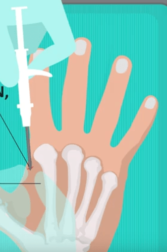

For your placement use the TP setup, not the box.

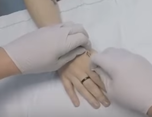

I’m not sure that this video is that great at showing the install site position, it appears to be closer to the base of the index finger than in some of your installation videos - like here:
vs here:
Back on topic, I hope your implant works out @Zeno
The important bit is parallel to the index metacarpal bone. How far down is related to the hand in question.
