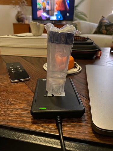

This was generate on key, if I understand the interface correctly. Let me try again and document ![]()
Importing (not generating, however some frontends don’t actually generate on card but instead sideload a key generated on your PC) keys which are not RSA-2048 or NIST-P256 requires a specific reconfiguration command: flexsecure-applets/docs/applets/1-pgp.md at master · DangerousThings/flexsecure-applets · GitHub (Key import fail with "Invalid value" error · Issue #15 · github-af/SmartPGP · GitHub). You can look at the CI tests for the SmartPGP applet at e.g. flexsecure-applets/scripts/test/SmartPGP.default.bats at master · DangerousThings/flexsecure-applets · GitHub and flexsecure-applets/scripts/test/res/SmartPGP.common.sh at master · DangerousThings/flexsecure-applets · GitHub for in-depth details.
Seemed to work this time, may be quite sensitive to field strength and positioning as attempt immediately beforehand failed, and then another try after removing and presenting the card again.
On the previous attempts where key generation has failed the card also stops responding to all commands until removing from the reader field and trying again.

This appears to be RSA2048 . In general, I’d recommend using elliptic curves instead of very large RSA keys (>=3072), due to memory usage - if your systems support these newer algorithms. Also keep in mind that generating large primes or elliptic coordinates takes considerable time (depending on available entropy and compute performance), so make sure to power your token long enough.
Also, importing a pre-existing key you generated before on your PC is faster than generating on-card and allows you to backup your keys a bit more easily. However, generating on-card might be required for your security model.
